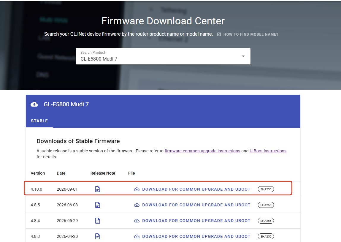

I’m sorry but this firmware seems to be broken. The screen wouldn’t light up after resetting the device. I couldn't turn the screen on at all. I didn’t observe the pattern but it was alarming when i saw the wifi on (on my phone) and no screen to disable it. This is a huge security issue with regards to close quarters threats, when one is expecting the screen to function predictably. I promptly reverted to previous firmware.
It occurred to me might your firmware webpage have been hacked? The checksum matches with the firmware I downloaded.

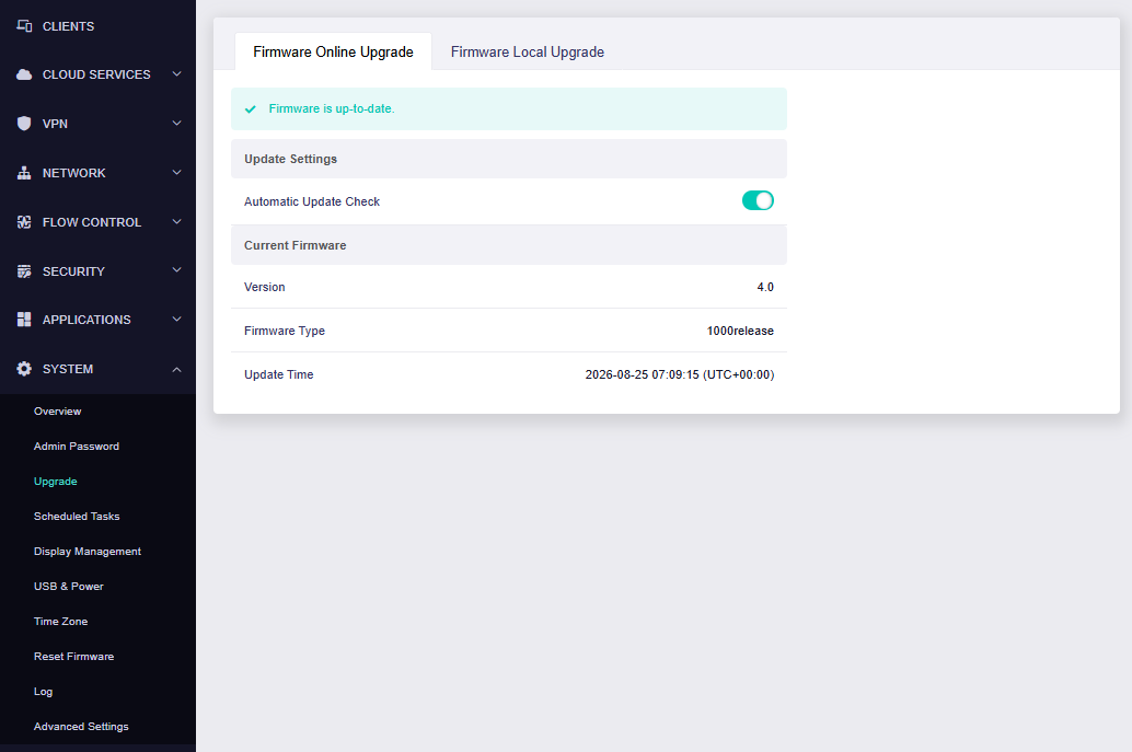

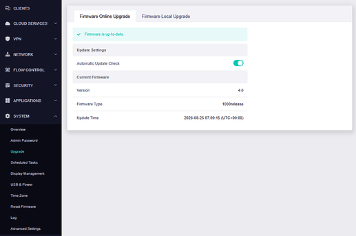

We checked the GL.iNet Download Center and were able to download the Mudi 7 firmware normally, and the firmware upgrade also completed successfully on our test device.
The firmware file we downloaded and tested is:
e5800-4.10.0_release5-1092-0825-1787643675.zip
After the upgrade, the firmware information on our device is shown below.
Could you please let us know how you performed the firmware upgrade when the issue occurred?
If convenient, could you please try upgrading to this firmware once again and let us know whether the screen issue can still be reproduced?

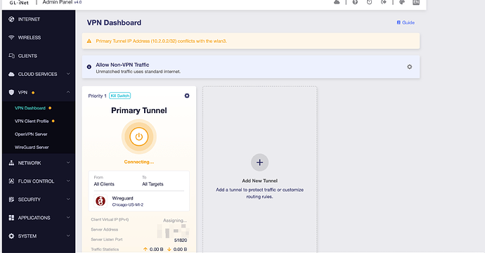

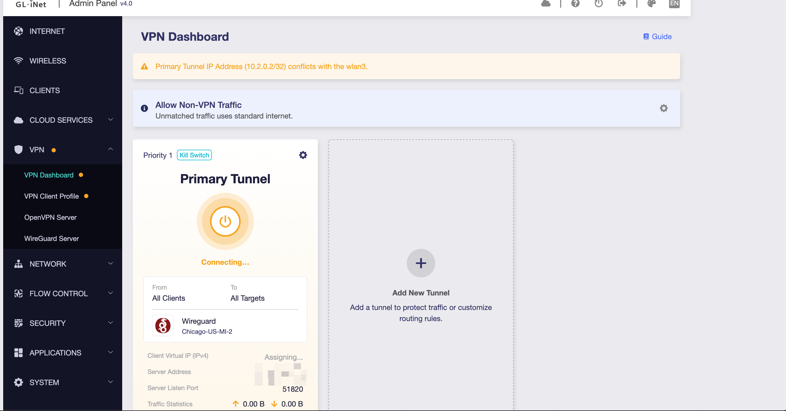

I am running into a similar issues as this, but on wan3. I am using the Mudi 7 as a repeater on a hotel guest network and am unable to connect to my VPN. Both my wireguard home vpn and protonvpn. I used the admin page to upgrade to the latest firmware and just now also installed the latest firmware from the linked above page. Both ways I get this error message:
Primary Tunnel IP Address (10.2.0.2/32) conflicts with the wlan3

Edit: Downgrading to firmware 4.8.5 works fine, I am able to turn on my VPN. Seems to be an issue with the latest firmware 4.10.0
Thank you for the detailed feedback and information.
From the information you provided, wlan3 obtained 10.62.150.177/8 from the upstream Wi-Fi network. Since the /8 prefix includes the 10.2.0.2 address used by the WireGuard tunnel, firmware 4.10 may therefore be detecting the two networks as conflicting.
