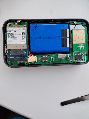

hello, I became the owner of the GL-E750 (ep06) and decided to install the em160 module, but on the factory firmware it only works in 3g on ttyusb3, I decided to install the firmware from

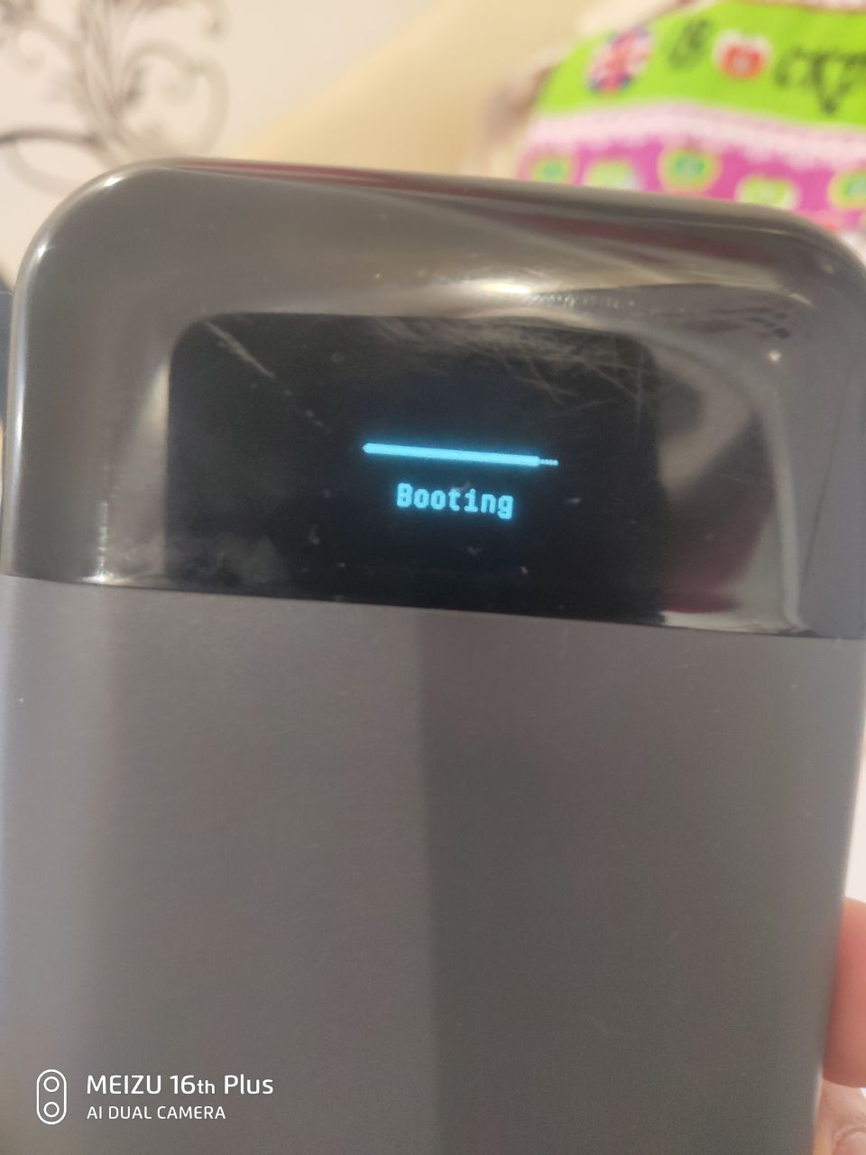

the firmware does not start, wi-fi is not available, the lan wire is not available, the firmware freezes, I managed to run only the stock firmware openwrt and ito cherz times

I flashed both through the web interface and using uboot, I also tried to install openwrt first and install ROOter through its web interface, in all cases I get reboots, at most I managed to go to the starting country of ROOter, after which I received reboots, and I observed an unknown device in the network card
I recorded a video with an error, watch it
Sorry. I tried and it is the same.
The firmware cannot boot.

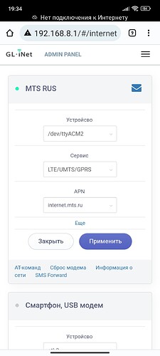

well, then please tell me how to run other models on the mudi firmware, such as em12g em160 T77W968 Fibocom L860/L850? not one of them, the mudi firmware cannot adequately run.
this problem has already surfaced, and there is no solution, that’s why I want to run the ROOTer firmware, since it sees them perfectly and launches modules, I have already checked
Did you use m2 to pcie adatper and connect these modules?
yes, I connected pcie adatper, I run both 968 and em160, both of them worked in 3g, but I was able to run em160 in 4g through raw IP changes, and I did not understand how to run 968 in 4g, both modules worked on the ROOter firmware and 4g

I will hope very well that you will release the necessary firmware for the models, by the way Fibocom L860 also launched on the mudi firmware and it immediately identified the operator and the Internet appeared, also on the 3g network, I think the wrong port for the models is set
