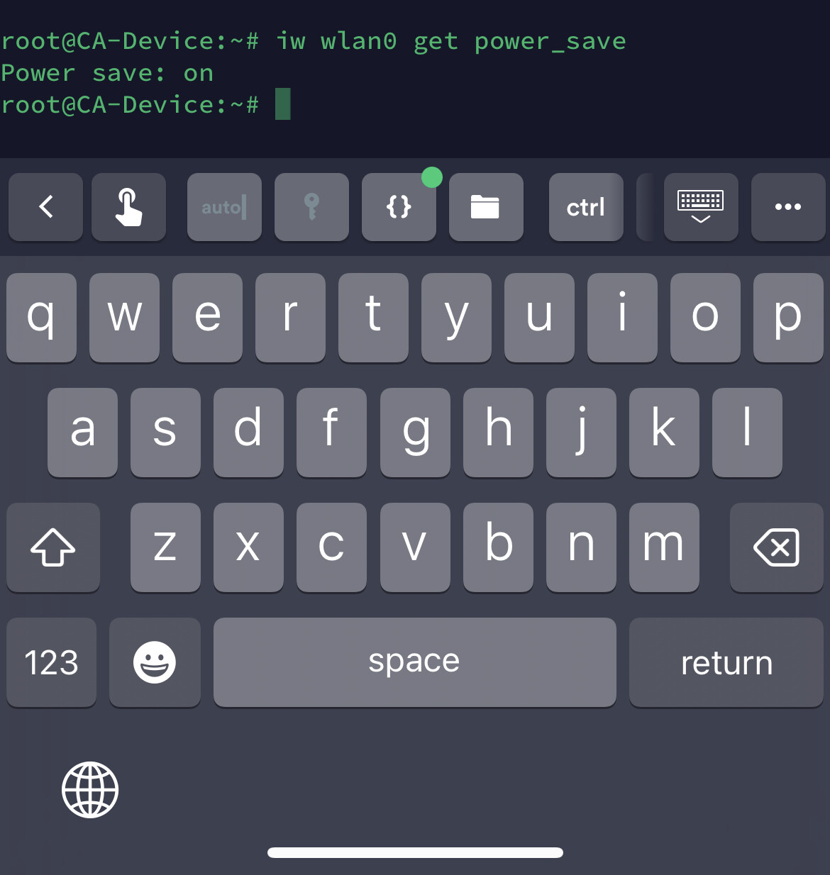

@ZeroZorro I looked into the possibilities of this a bit further. There does appear to be a powersave state:
It appears to be enabled by default on the GL-AX1800, not sure about your device. You can find more info in the archives here: OpenWrt Forum Archive
There’s not much information about it, so I do not know how effective it will be, but it’s worth a try I suppose

So on E-750 it seems OFF by default
Interesting, I’m running beta V4.0.1, so maybe it’s changed there.
But in this case, I’d say turn it on & see how it goes😄
