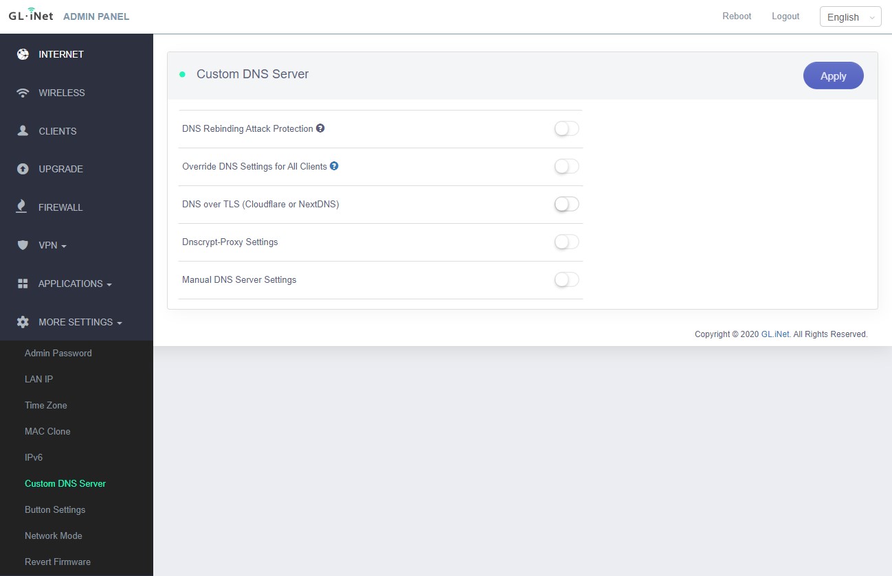

Does it make sense to change anything in the DNS settings? When i log into my Mudi interface, i see the following settings under Custom DNS Server:
Is there anything i can do to protect my DNS?
Keep the default settings of the 'Custom DNS Server', the DNS traffic will be through the VPN tunnel.
