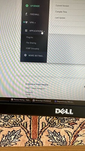

GL-INET Admin Tool does not show option for remote access (only Plugins, Files Sharing and IGMP)
mit GL-INET Admin Tool does not show option for remote access (only Plugins, Files Sharing and IGMP). So, I cannot connect to goodcloud.xyz.
It is a GL-AR300M-7af, firmware 3.2.16. MQTT package in installed, however gl_mqtt is not found.

Unfortunately, this is not true. 3.216 installed, but the option is still hidden. What to do?
