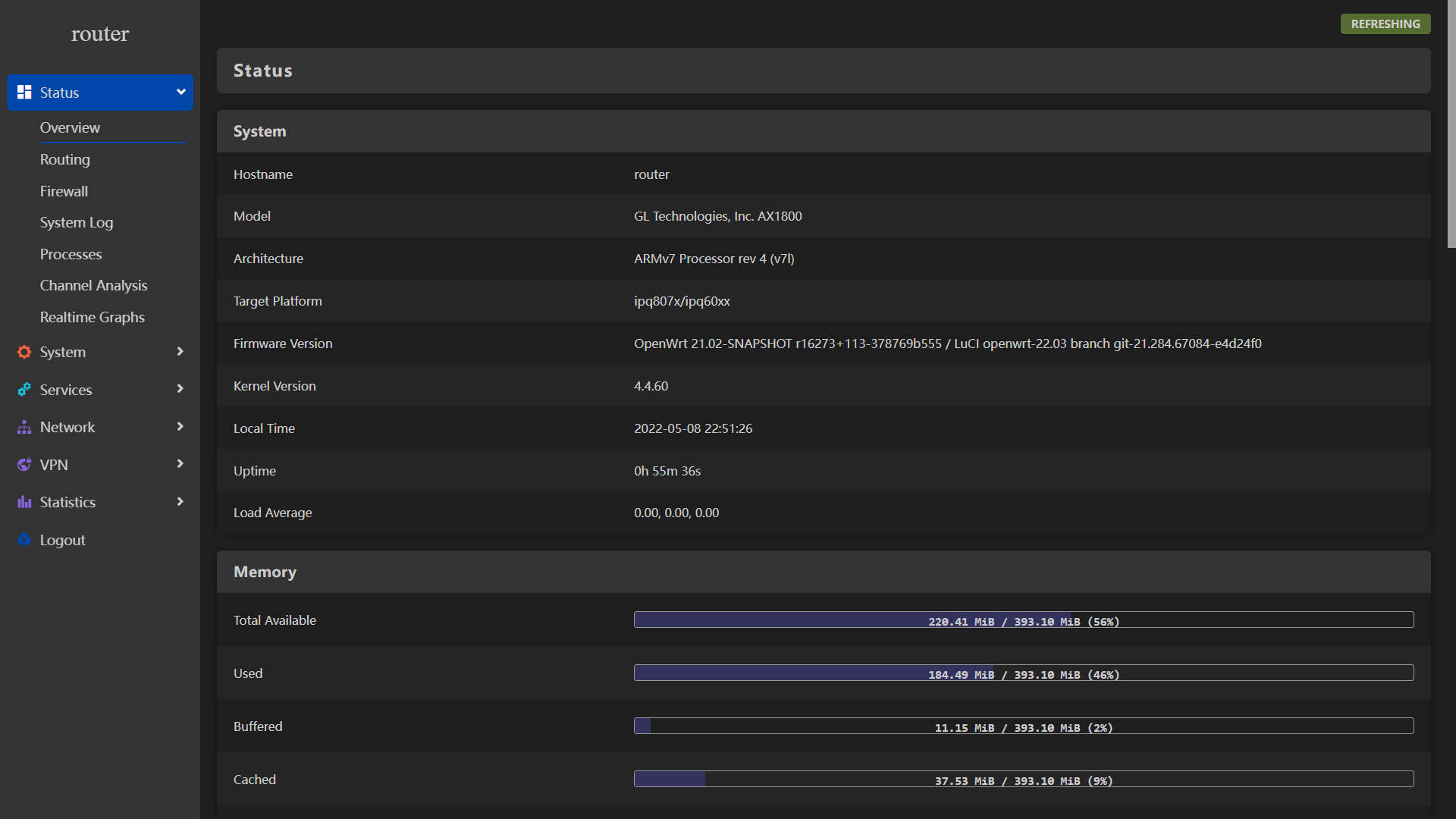

Right uploading the files to the mirror, this will take 2 hours to do as its a full compile of everything.
If you have downloaded the R16273 build from Mega.NZ after 2 hours 30 minutes from this post just run an OPKG update to grab the new list of files.
Also head over to OpenWRT forum to thank @Gustavargas for donated resources for this project, and respect his box like you have mine.
I have sent this message via
There is a bug in OPKG as the firmware images just made with the full compile crashes.
Please head into Software - > Configure OPKG and change
dest root /
dest ram /tmp
lists_dir ext /var/opkg-lists
option overlay_root /overlay
option check_signature
To
dest root /
dest ram /tmp
#option check_signature
Also remove the // from r16273//packages to r16273/packages .
It should then work after that.
OPKG adjusted. Repository working after adjustment on my side. Build seems stable. Thank you for the hard work.
No problem, just trust my luck. I made 3 builds before hand to test for consistency all of them worked fine re-ran the compile and the 4th happened to cause a reboot loop.
If you notice bugs please report them, I have noticed that although UPNP is working the firewall rules for upnp is missing not sure why so looking into that.
Will do.
I do not use UPNP, but hopefully someone here who has issues will notice this thread.
