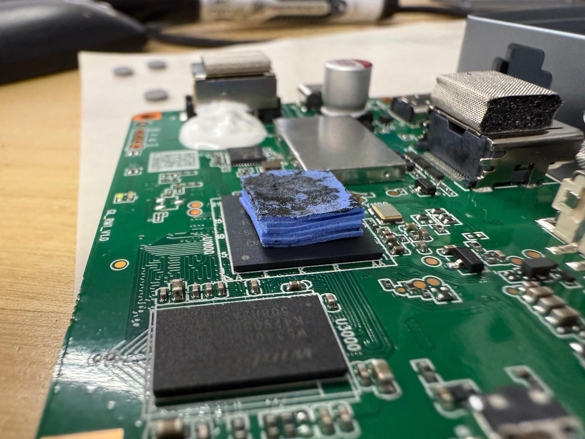

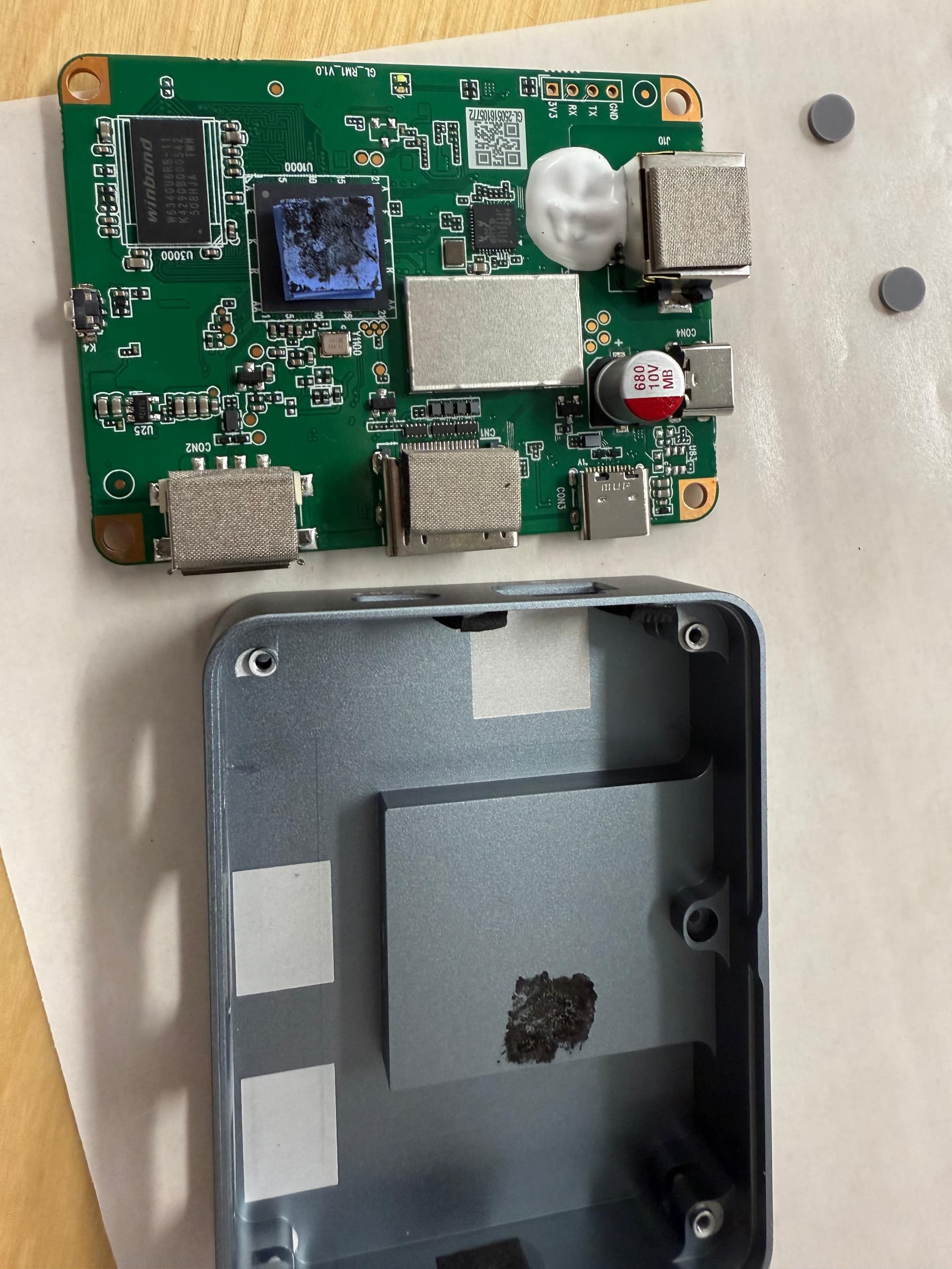

Your post intrigued me so I opened up the second comet I received.
It would seem the rockchip SOC is not touching the heatsink. I had to add ~3mm of heat transfer pads for it to make contact:
I am not deploying this one yet, but if you have access to heat transfer tape, open yours up and test!

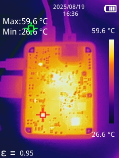

thx for the tip. i did the same. to test it out, i ran youtube playing with audio via KVM for a bit. my unit has stablized at 59.4 for "0" and 57.9 for zone 1. my room temp is about 24c.
I did noticed one spot (~59c) on the back side of the PCB is hot. i also added some pad on the back side to help cool it down.
