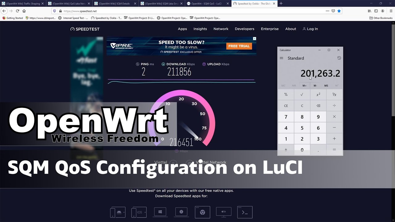

You could also try SQM setup
https://www.bufferbloat.net/projects/bloat/wiki/Getting_SQM_Running_Right/
