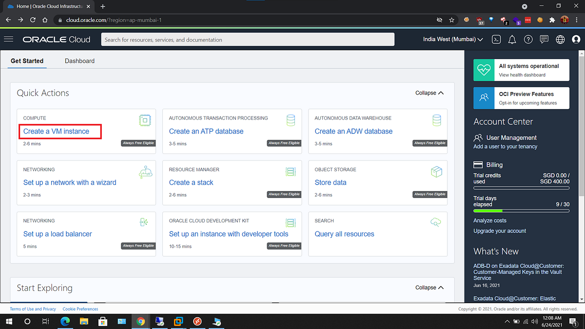

Something to get you started, on oracle cloud but others will be similar:
I guess I should add that this doesn’t get you more speed site to site, but is of more use if you don’t have a public IP address to reach. Each site connects out to the cloud site, and to each other through the site. But you are still limited to the upload speeds on each side.
The free tier OCI instance gets you 500/500. The priced tiers vary, but very quickly get you to 4G/4G. But for OCI you are limited to a particular region; if you choose Frankfurt, for example, you can’t geolocate yourself to Australia.
