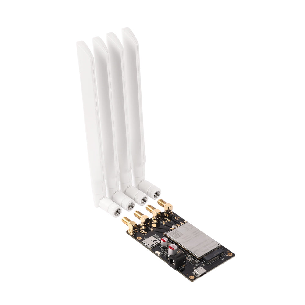

What model of modem are you using?
This one
Spoke with EE tech support , they were impressed with the modem and Slate AX router.
Said it was wifi 6 compatible.
They said the M2 was a great bit of kit and that they have now allowed it to connect with their base station.
From the Router number and IMEI number.

What external antenna for 4 & 5G would you recommend ?
The M2 has 4 SMA connectors, do I need 4 aerials or can I have one aerial with 4 wires ?
We have two kinds of external antennas to recommend.
#1, Panel antenna for home usage:
#2, Dome antenna for RV usage:
