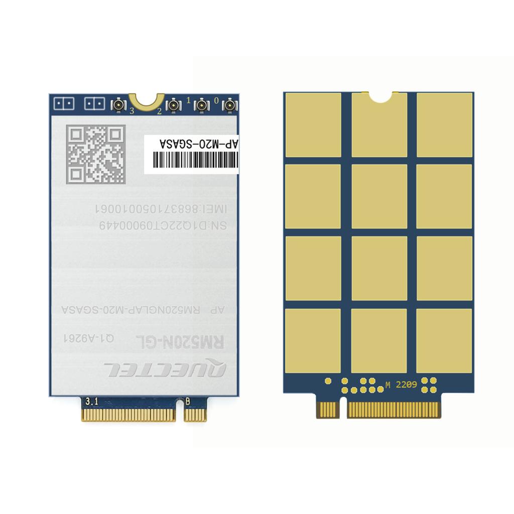

This might not be a great news but I can see a sticker on your module which is common to RM520NGLAP variants which only works on certain laptops. You need RM520NGLAA ( Quectel RM520NGLAA-M20-SGASA) or even EU will do. You got scammed unfortunately...
However, if you can confirm that it is indeed an -AA variant and not AP (since I tried zooming and still can't read the variant name) then try these commands once you had a connection from your laptop to the module:
AT+QCFG="data_interface",0,0 to set the AT port to use USB rather than PCIE (since development board is using USB as an interface
AT+QCFG="pcie/mode",0 default mode for using USB interface
AT+QCFG="usbnet",0 to set the module to RMNET USB protocol. You can also use ECM (1) but I don't know if the development board supports it. It will get detected as an Android Tethering if ECM was used.
RM520NGL-AP which is wrong and you shouldn't buy:

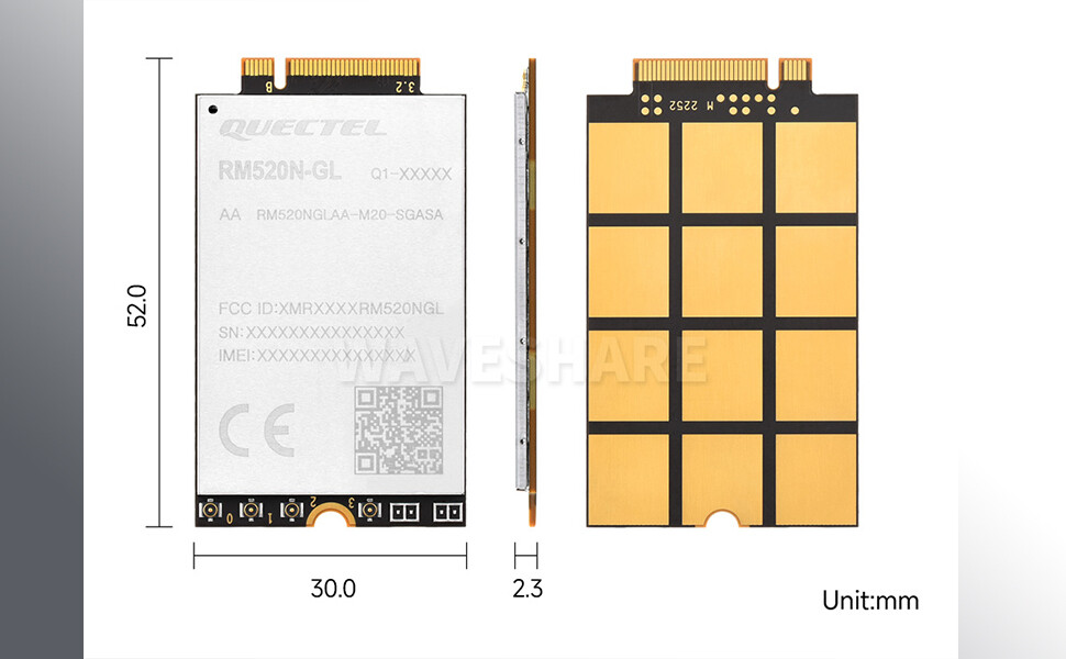

Correct module to buy RM520NGL-AA

You need RM520NGLAA ( Quectel RM520NGLAA-M20-SGASA ) or even EU will do
What you mean about EU will do? there was another EU variant? Which one?
RM520NGL-AA is a Global variant while RM520NEU-AA is European. Theres some Carrier Aggregation (CA) combinations that are different from each other so check if whats better in your country (if US, then GL is better I think). As long as its not an AP variant then youre good. However, feed back from GL inet would be better to confirm if theres a known problem with their board and EU variant just to be safe.

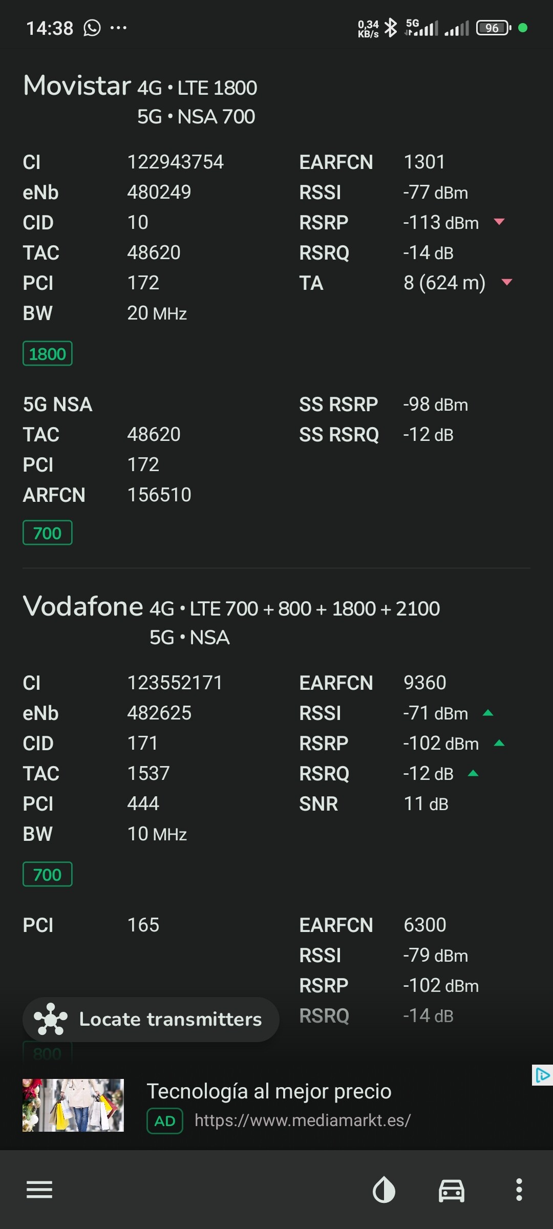

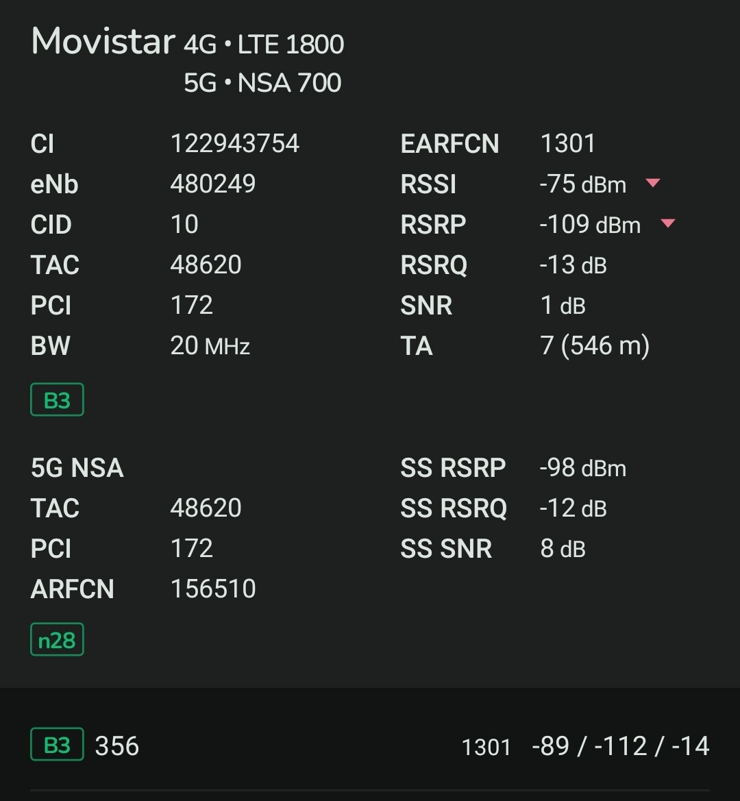

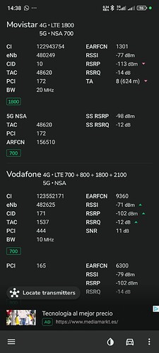

I get this results on my phone (i have 2 sims inside)
You can use EARFCN calculator to then know what band it is: ARFCN Calculator - Cellular Coverage and Tower Map or change your settings:
hamburger icon -> settings -> monitoring -> change band in cell location option from band name to band number
Also the signal readings were both pretty bad. You may need an external antenna or a good place for you development board where reception is good.
