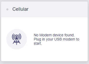

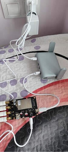

Hi i have Beryl router with gl-m2 board attached as you can see on the picture, but the router display:
No Modem device found. Plug in your USB modem to start.
The router firmware now is 4.5.16, what i am doing bad?

Connection is good. Bad cable?
everything is connected fine, and all brand new buyed from your webstore... except the RM520N-GL card , regards.

This appear on my Router:

no, i have only one inserted on the glinet m2 development board as you can see on my first picture
