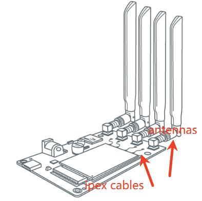

Hello, to troubleshoot this issue:
  1. please check and make sure all antennas and the IPEX cables are connected properly and firmly
  2. if antennas are connected properly and the issue persists, please run the following AT command and post the command here to check.
    AT+CFUN?;+QNETRC?
Many thanks.
