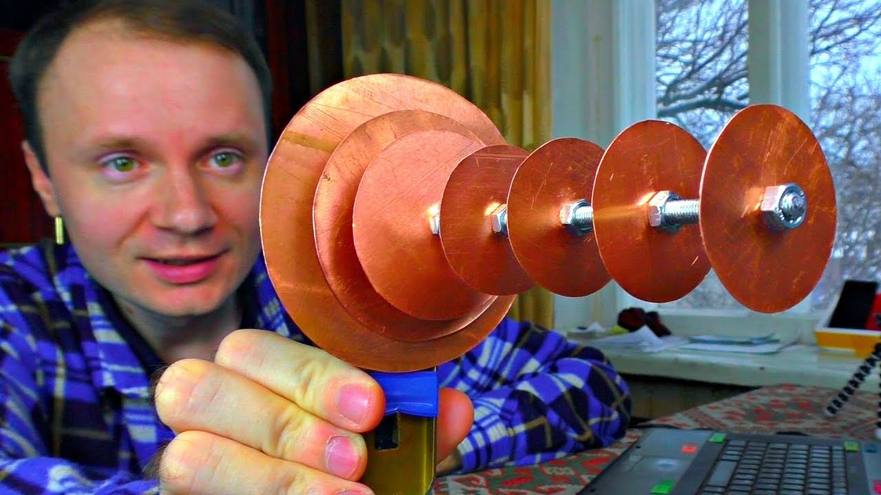

You can also make your own and test:
Those guys were able to get very long range, 10km or more from one part of the city to the outskirts.
