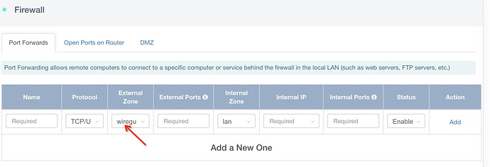

@alzhao Do you have a tutorial how to manage iptables and set port forwarding correct? I tried it many times, but it doesnt work for me
When set up port forward, just choose the correct external zone.
