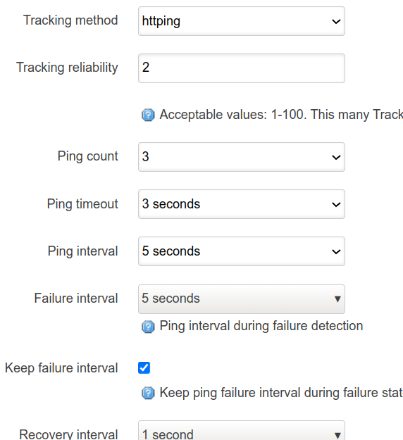

However, I am unable to set httping as the “tracking method” on the T-Mobile interface.
I get an error " * One or more required fields have no value!" without mentioning which exact fields are missing.
2023-03-21_18-58-mt1300-httping-err
Any guidance to get past this error message would be appreciated.

Is this on Luci?
What is the firmware version of MT1300?
Want to have a test but better do the same as yours. Can you post screenshot capturing all the fileds you filled?
Yes, the error is on the Luci web UI.
The firmware version of MT1300 – 3.215
From what I have observed the “ping” tracking method has two items more than the “httping” method:
  1. Max TTL and
  2. Check link quality
See the screenshots below.
Ping options – screenshot
2023-03-23-mwan3_ping_checks
Httping options – screenshot
IMO, the bug is in the backend scripts and not in the Web UI. When I ssh into the unit, I see 'uci item not found."
