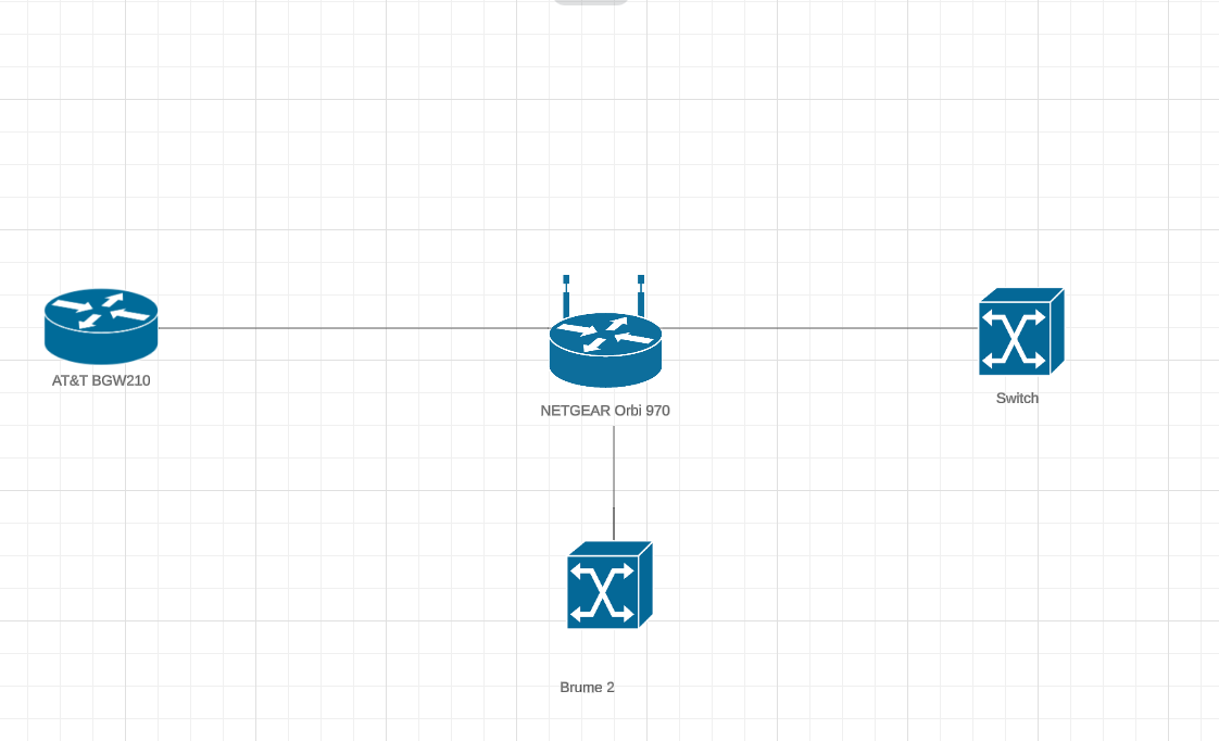

Seeking to setup a Wireguard Server with the Brume 2.
Current network setup:
(EDIT Brume actually attached to Switch)
AT&T BGW210 (Passthrough enabled & WiFi turned off) :arrow_right: NETGEAR Orbi 970 (Providing WiFi and all IP addresses for the entire network) :arrow_right: NETGEAR switch
Orbi router's IP is 10.1.2.3
Brume 2 Default Gateway: LAN IP 192.168.8.1
Brume 2 IP assigned from Orbi router 10.1.2.10
When I go to change the Brume 2 LAN IP address from 192.168.8.1 to 10.1.2.5 I get the error message from the Brume 2 "LAN subnet is in conflict with the WAN subnet, Please Change LAN Subnet to a different address"
I can only connect to the admin panel if I directly plug into the LAN on the Brume 2 which gives me an IPv4 address of 192.168.8.166

Yes, the Brume 2 WAN is connected to Orbi 970 LAN.
So I'm having overlap with the Brume 2 LAN and the Orib 970 LAN range?
:pushpin:Brume 2 LAN: 192.168.8.1
:pushpin:Orbi 970 Router: 10.1.2.3
:pushpin:Brume 2 (on Orbi network): 10.1.2.10
The Brume 2 is currently on the Orbi network with the assigned IP of 10.1.2.10 but I cannot ping 10.1.2.10 device.
I port forwarded the Brume 2 10.1.2.10 on my ISP AT&T router.
Did I port forward the wrong IP address? Do I need to port forward the Brume 2 LAN 192.168.8.1 instead of 10.1.2.10?
I want to setup a Wireguard server on the Brume 2.
