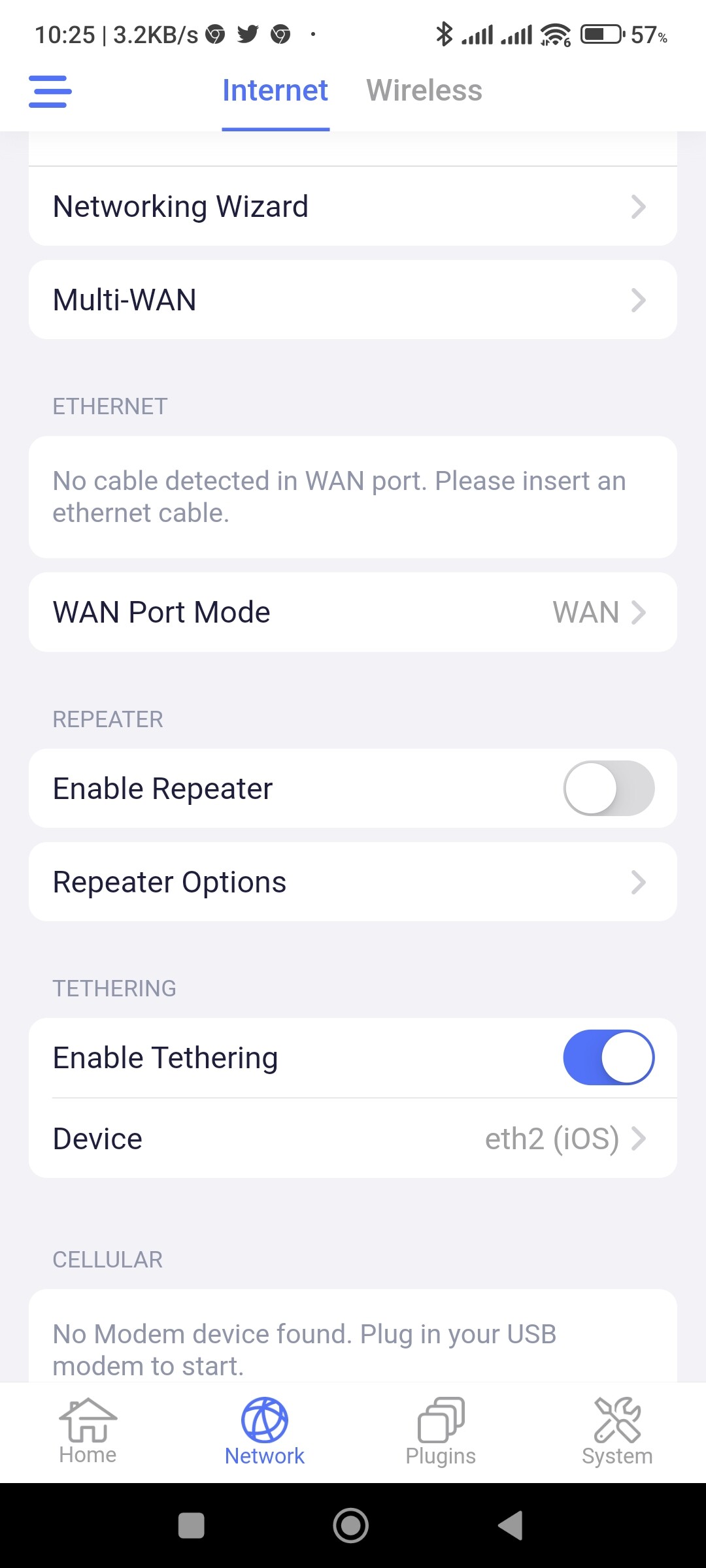

Tried with slate ax 4.1 and glinet app
The tethering in the app always show as on, clicking the disable button will disable tethering with app
But since it still shows on, I can’t enable tethering with the app
@yuxin.zou
The bug should be on the App 2.0 beta, not the firmware.
There is a problem with the enable tethering switch status. You click on the second line (Device eht2(iOS)) and it should set up correctly.
