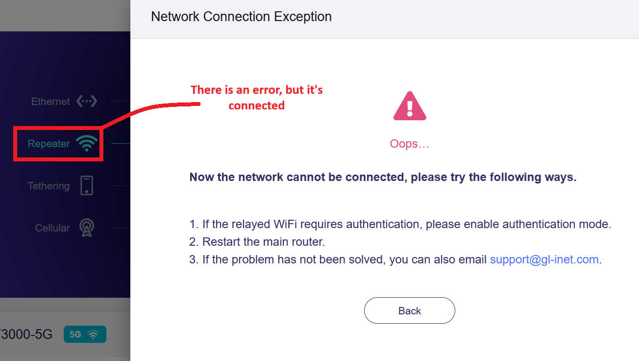

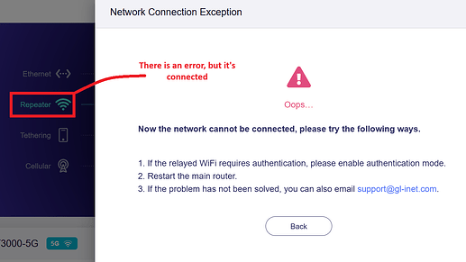

When asked the mode, I choose “Repeater”. I choose the network to connect, typed the password and then an “ops” error pop-up, but MT3000 is connected correctly (I’m connected to it, from the LAN Port, and the internet is working fine).

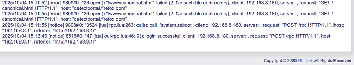

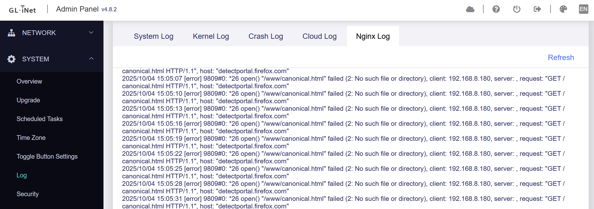

The log is full of these errors repeated every 3 seconds:

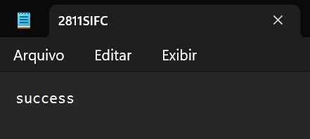

If I go tho this address detectportal.firefox.com my browser download a file. If I check the content of this file, there is a text saying “success”:

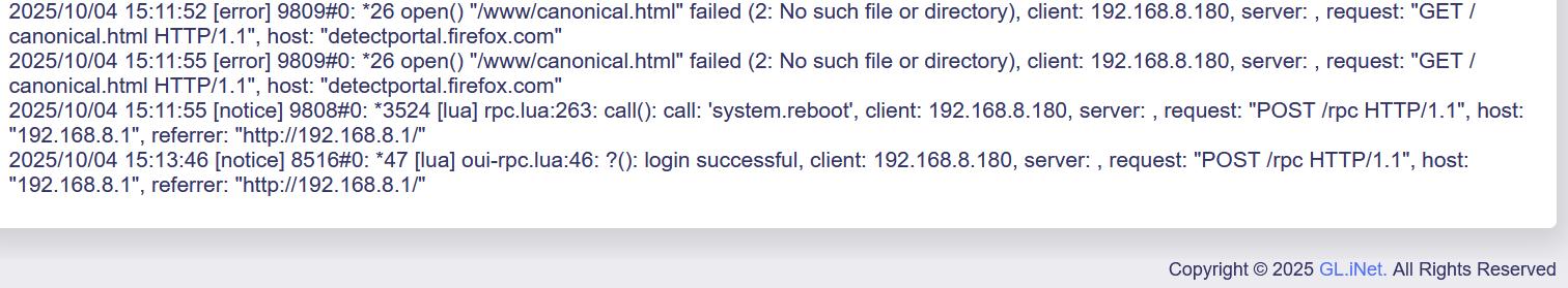

After the reboot, it seems the error stop:

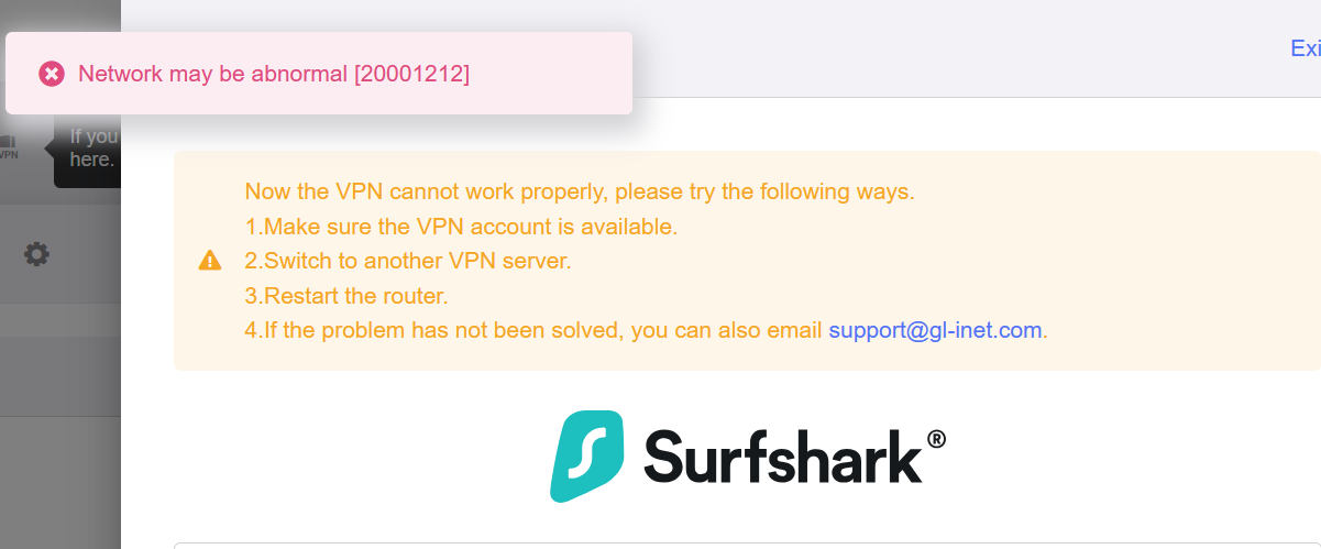

Tried to set the VPN… And I got this error:
The error message above appears to be caused by a feature in Firefox.
Excessively frequent requests to the router UI interface may have caused some issues.
If you disable this feature or switch to a different browser, would similar problems still occur?
You can disable this feature by going to about:config and setting network.captive-portal-service. Enabled to false.
