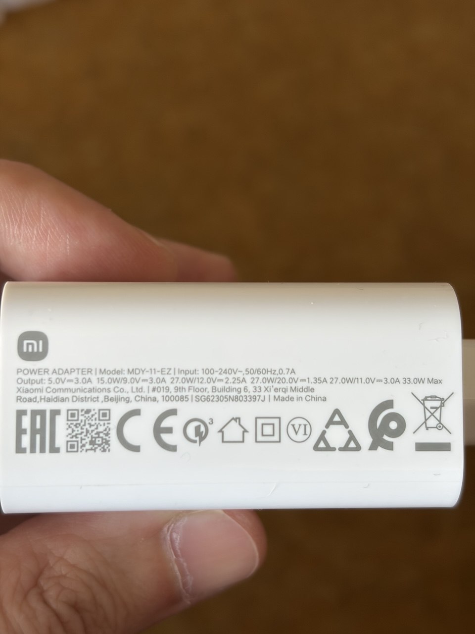

  1. Are you currently using the original power adapter or another one that meets the 5V/3A specification?

  1. I didn’t have the original adapter in the package, so I’m using another one 5v/3a.
