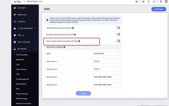

Have you enabled the button shown below? Enabling this option will use the custom DNS upstream to override the one specified in the configuration file.
Or have you enabled adguardhome? Adguard enabling the handle dns option will also override the VPN DNS.
