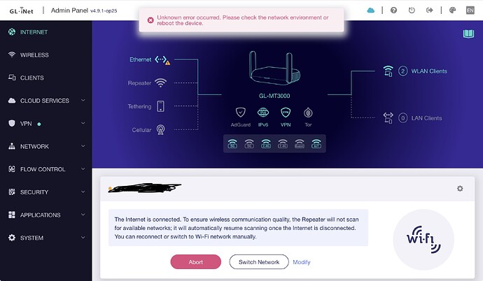

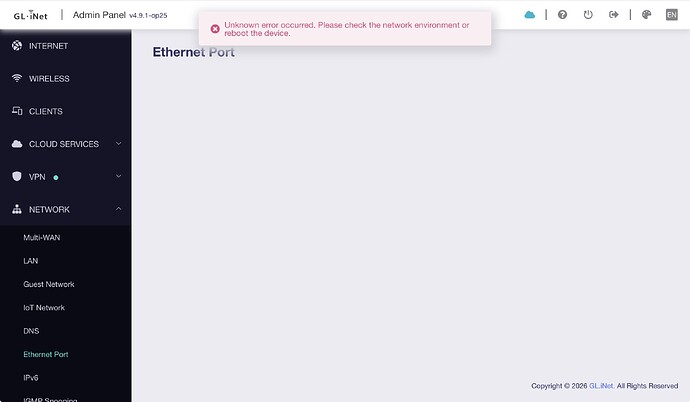

There was recently a thunderstorm in my area, causing a power outage. After the power restored, I can no longer access the Ethernet settings in the GL.iNet panel. However, Ethernet connections (WAN/LAN) work fine. In the Internet and Ethernet Port settings, it displays “Unknown error occurred. Please check the network environment or reboot the device.”. Even after rebooting the device several times, it never restored properly. A factory reset gets it working properly until I upload the archive file, and then it has this issue again. It was probably because of the sudden power loss in the middle of the router writing to the flash. How do I make sure this doesn’t happen again in normal circumstances? (Eg. when I unplug it)
(Internet page with the error, and Ethernet box does not show any information)
(Ethernet port page)
