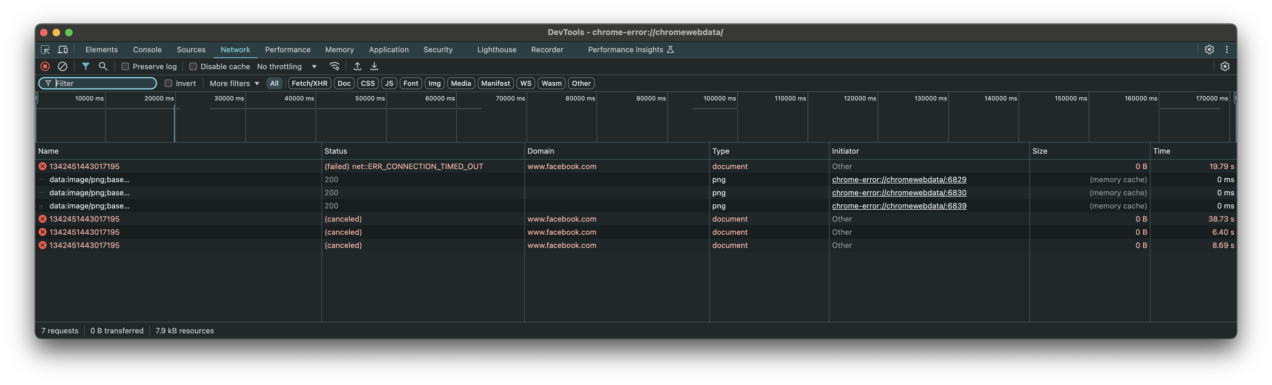

I was testing out the "VPN Policy Based on the Target Domain or IP" using the option of listing out domains to not use the VPN ("Do Not Use VPN").
But finding out that with the facebook.com domain, it fails to load with the chrome networking error:
(failed)net::ERR_ADDRESS_UNREACHABLE

Please upgrade to the latest firmware.
I did not reproduce this issue on my MT3000 and Edge (Chromium).
Probably the DNS cache does not refresh or clean, for the MacOS:
sudo dscacheutil -flushcache; sudo killall -HUP mDNSResponder
Will other domain names do this same situation?

Just tested it.
"Do Not Use VPN" option not working correctly.
I'll have to test it with a full config reset.
The dns cache flush command did not work for this case.
Other domains work just fine with it.
