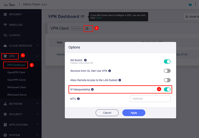

Please go to Admin Panel → VPN → VPN Dashboard and check whether “IP Masquerading” is enabled.
If it is already enabled, please run the following command on your laptop for further checking:

Hello, thank you for replying. Yes IP masquerading is enabled. Please see as follows the result of the commands:
