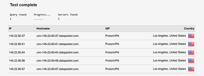

Check here which DNS you are currently using.
Not sure how the result should look like, but I would say this is fine.
