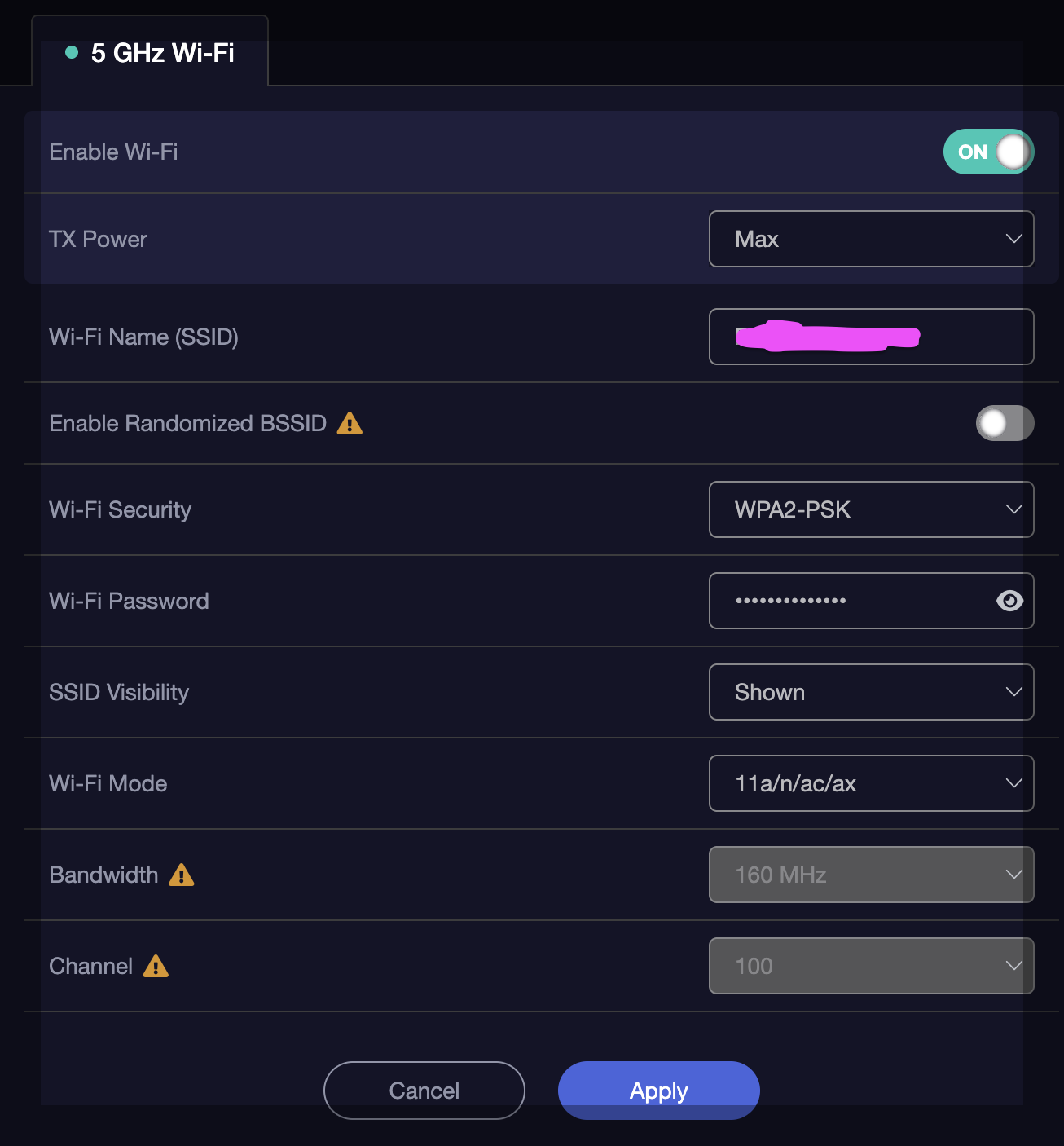

I am not sure what happened, but the router is now (several days later) repeating in 5GHz DFS mode, see below. I made no changes to my setup. It looks like the FritzBox decided to change the 5GHz channel to channel 100, which convinced the MT6000 to connect and repeat.
I am happy to report that everything feels much snappier and the connection is signficantly faster.

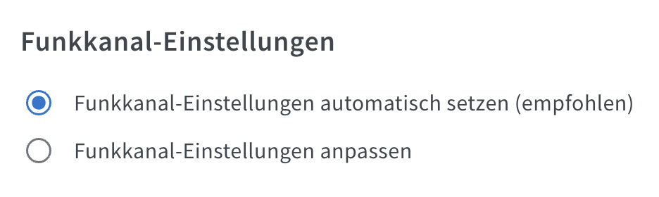

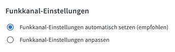

Do you remember which channel was the last time of Fritz Box?
It sat on channel 36 before (again via auto selection).
