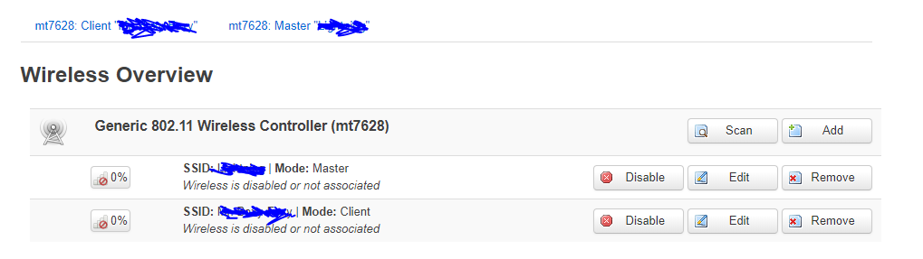

in your screenshot it appears you are not in wisp mode - is that right?

At the moment I dont have it in WISP mode, but internet over LAN in the WAN port and it’s own WIFI. In WISP mode I can’t use it because it is to slow.
When I tried to use WISP mode, i unplugged the LAN cable, I also rebooted it, powered it off waited for for the light to go off, waited an extra 5 second and connected it again with power.
