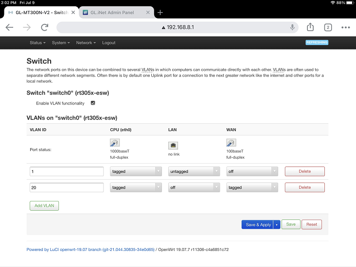

Firstly apologies for raising this thread from the dead, but it exactly matches what I am trying to do.
Based on the screenshot from @robotluo above, I installed Luci and configured this:
However, my MT300N-V2 never gets an IP with a cable plugged in the WAN port. Other devices in the home, using VLAN 20 work correctly, so I know it’s not a server issue.
And here’s the network config:

The VID must be associated with ifName. For example, if the ISP requires the VID to be 100, the ifname must be eth0.100
