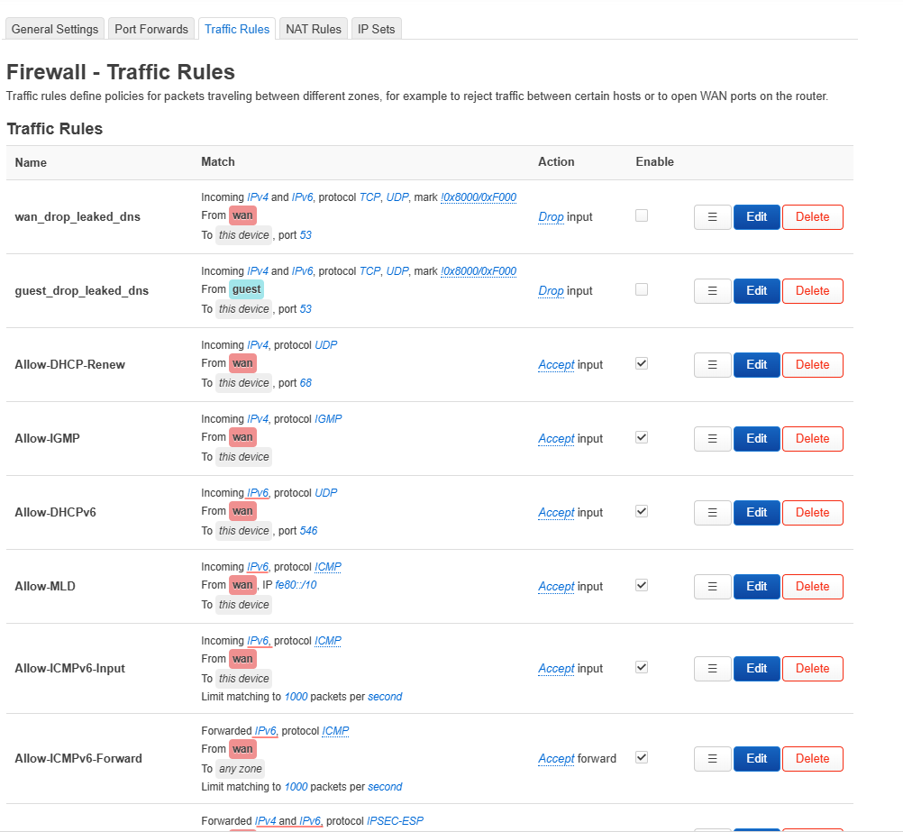

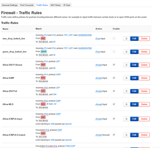

Okay, I see, the IPv4 and IPv6 dual stack firewalls are supported in v4.x firmware, that is including v4.7 and v4.8.

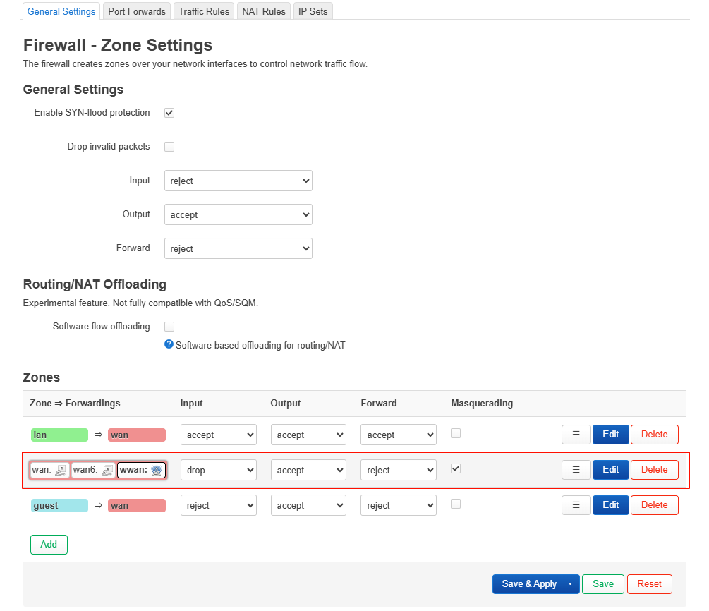

In the firewall, the actual IPv6 is the same as IPv4, which blocks some unnecessary traffic IPv6 data from WAN -> LAN unless the rules are manually configured (allow, deny, or drop, etc.) in Luci.
Thus the LAN IPv6 clients are safe.
So I do not need to configure anything in Firewall for ipv6 on 4.7.* firmware if ipv6 is enabled?
Yep, enabled IPv6 did not require to configure anything in Firewall, it is safe enough by default configuration.
