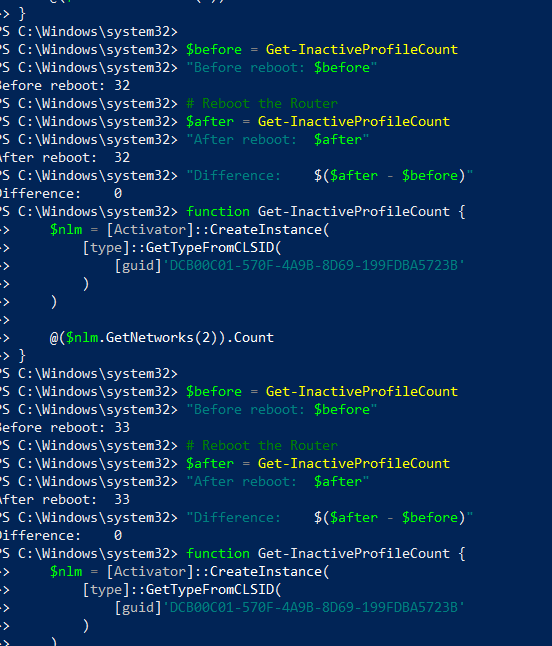

function Get-InactiveProfileCount {
    $nlm = [Activator]::CreateInstance(
        [type]::GetTypeFromCLSID(
            [guid]'DCB00C01-570F-4A9B-8D69-199FDBA5723B'
    @($nlm.GetNetworks(2)).Count
$before = Get-InactiveProfileCount
"Before reboot: $before"
# Reboot the Router
$after = Get-InactiveProfileCount
"After reboot:  $after"
"Difference:    $($after - $before)"

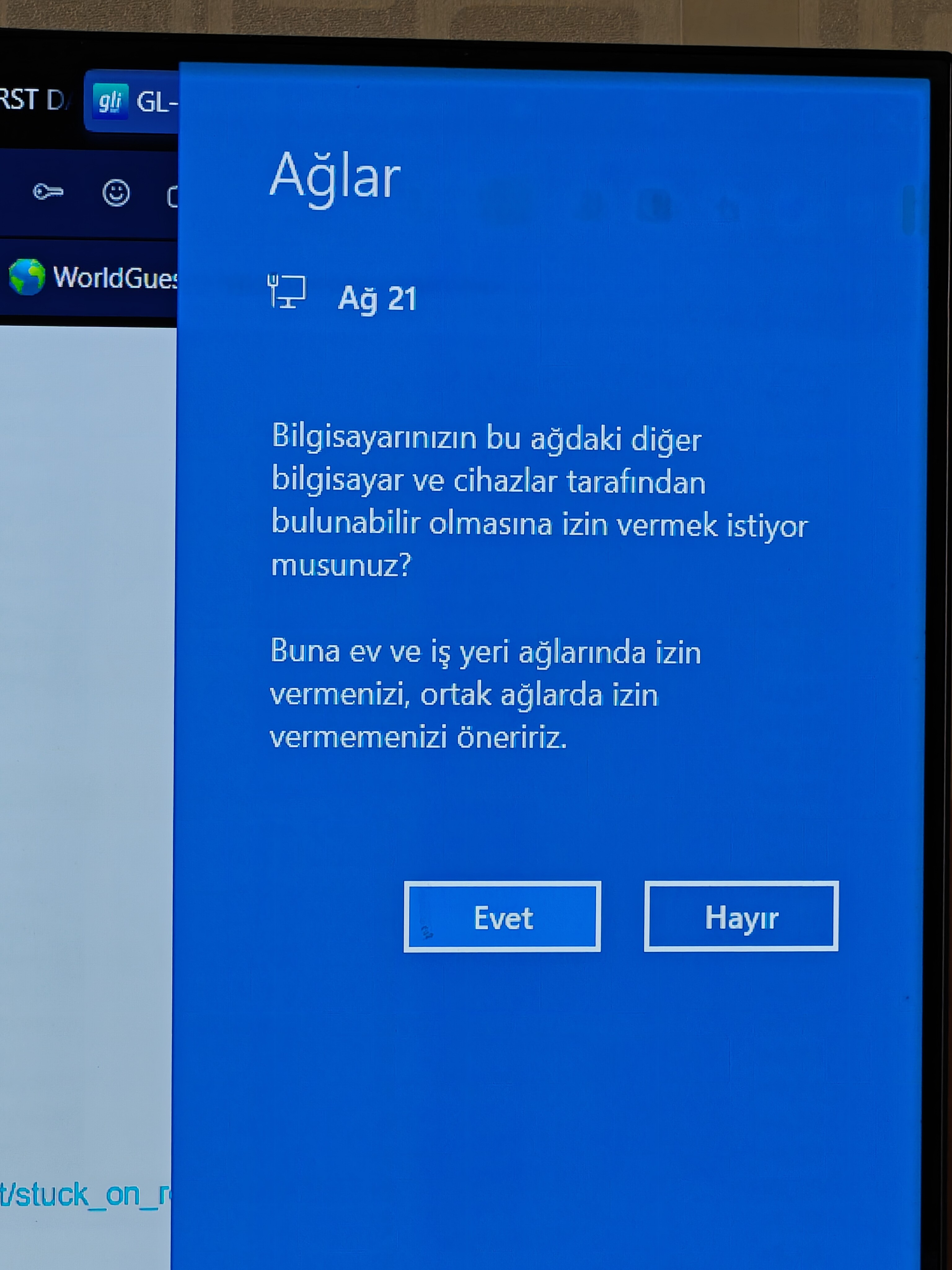

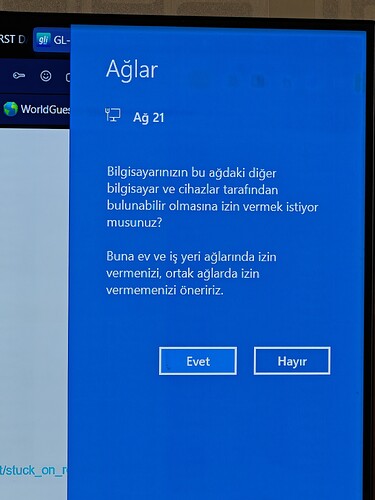

I have same situation. It was 32 before reboot and 33 after.
And I see this popup during reboot. It increase with every reboot. (It ask something about Pc can be found on this network)

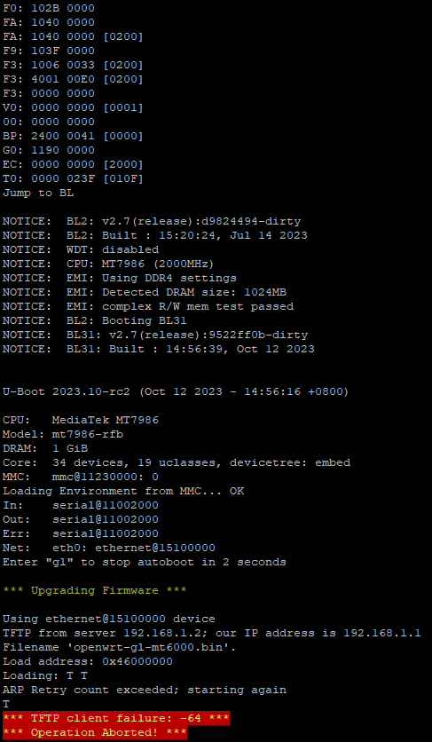

Hi Will. I did some research and found an interesting screenshot on the Internet showing a U-Boot UART log that clearly explains why the inactive profiles are created. Please take a look at the “Upgrading Firmware” section in the screenshot, where U-Boot attempts to find the openwrt-gl-mt6000.bin file via TFTP on every normal boot of the GL-MT6000 Flint 2 router, before loading the main firmware. This is what causes the inactive profiles with a random MAC address to be created.
As far as I understand, this is unsafe and creates a vulnerability that could allow hacker attacks on the device - there's no need to do this on every normal boot. This behavior is acceptable only when the reset button is held down for an extended period. So we are now waiting for an updated version of U-Boot from GL.iNet with this dangerous issue fixed.

However, what is strange is that, by default, U-Boot should not have a DHCP server running to provide a default gateway.

Regarding the issue of U-Boot retrieving updates via TFTP during the boot/reboot process, please allow us to investigate it locally and consult with our R&D team.

We have now confirmed that this issue occurs when the router's LAN IP is configured as 192.168.1.1, which is the same IP address used by U-Boot.
For now, if changing the LAN IP is acceptable for your setup, the temporary workaround is to use a different LAN IP, such as the default 192.168.8.1.
We will also continue discussing this with our R&D team to see how this behavior can be improved or fixed in the future.
