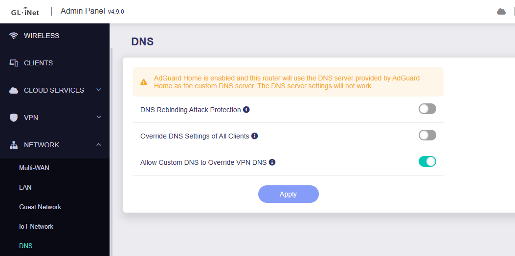

Network - DNS:
Enable the “Allow Custom DNS to override VPN DNS” option so that all LAN clients can use AdGuard Home filtering.

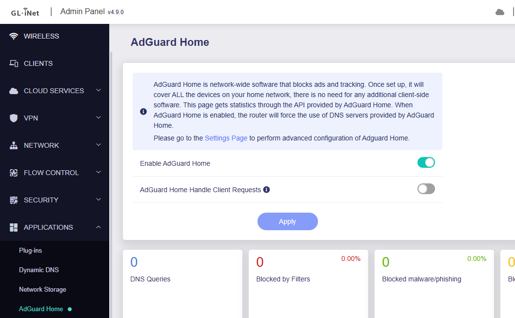

Application - AdGuard Home:
As mentioned earlier, we need to disable “AdGuard Home Handle Client Requests.”
