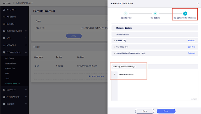

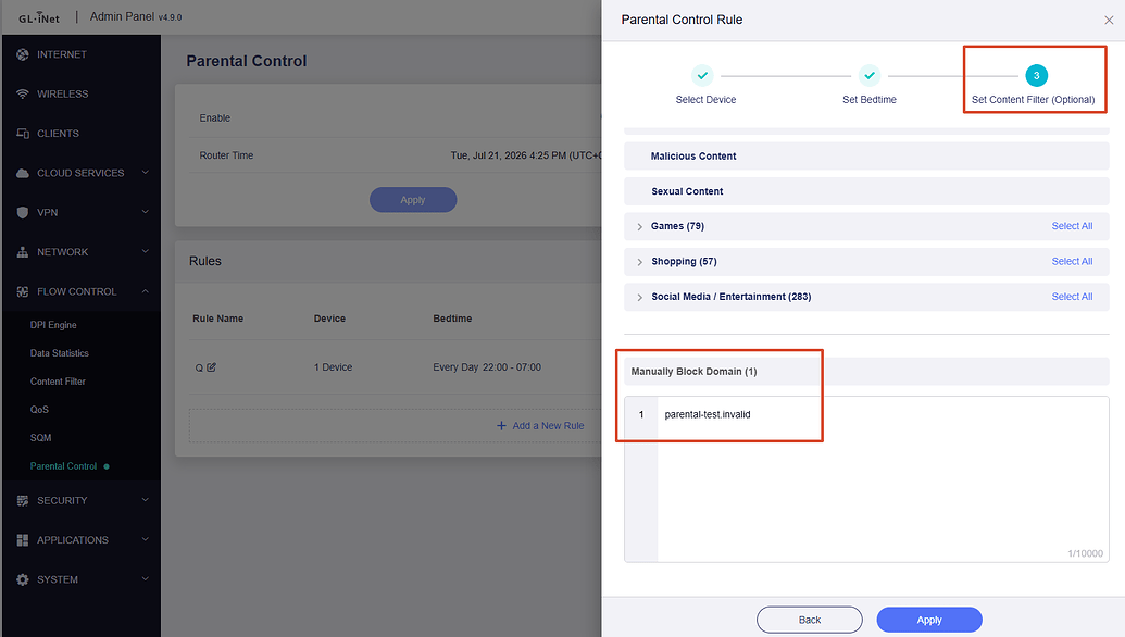

As we managed to resolve the issue, I will add summary here for other users.
The problem is connected with disruption of long-lived UDP connections caused by bug in 4.9 Parental Control content filtering implementation. The root cause has been found, and I understand the fix will be available in future version of the firmware.
But there is also a workaround available that helped in my case. It is enough to add at least one manually blocked domain to the parental control rule (can be bogus, like one I used: "parental-test.invalid" as in the attached picture), so the rule has at least one domain in content filter section.
