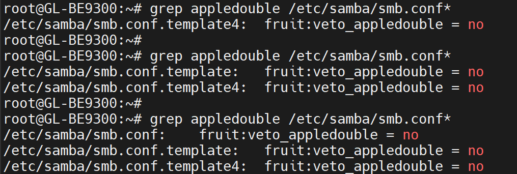

PS The Almighty AI explains it might be connected with some "MacOS resource fork" file handling. Well, maybe, but how can I turn this off? (or work the problem around somehow, permanently). Sadly, rsync does not provide a way to customize temp file pattern to avoid ._ collision.
PPS I have also tried to play with Flint's samba veto options, but with no success (there is a ._.DS_Store pattern on the list, but it is not just "any file starting with ._").
