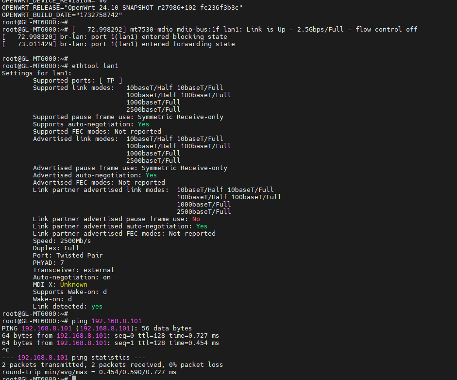

May I know what speed negotiation of the WAN of the Flint 2?
Check in the SSH by this command ethtool eth1

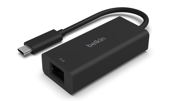

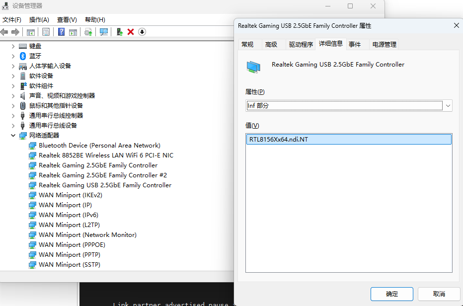

Belkin USB 2.5G adapter (NIC) is available to work with GL Router which has 2.5Gbps interface, and stable.
