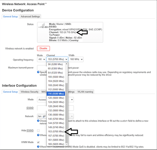

Hi everyone, I noticed a bug that was also present in the previous version.
By accessing OpenWrt Luci, changing the 5ghz Wifi channel I noticed that by selecting channel 153 or 5765 Mhz, when I save the setting, I find channel 153 at 6715 ghz, look at the attached photo. As a result I do not detect any active wifi from my pixel 8 pro.
Were you aware of this?

I found myself in a similar situation, its indeed a bug on openwrt side, also happen on the latest master without the gl software.
Made a issue on github here. :wink:
Do you per chance have this option active in your configuration or use a exotic option?
list hostapd_options 'enable_background_radar=1'
Though it can be a different issue, currently openwrt is rewriting its code for wifi7 the mt6000 cannot support wifi 7, hopefully they can fix it soon :wink:
It might take up to 10 minutes to scan for radar activity if DFS channel was chosen. During that period luci will show weird 5 GHz WiFi status.
