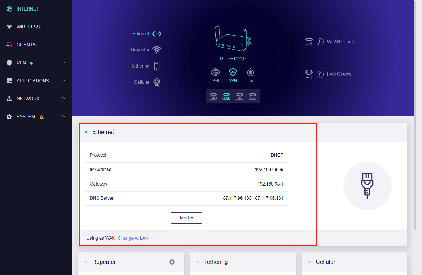

  1. Please make sure that the upper network is connected to the WAN port of MT6000. And check the INTERNET page of MT6000 to see if the IP address is obtained.
  2. Verify router settings
Log in to the router's admin page (Default IP address: 192.168.8.1).
Check the network settings, including the IP address, subnet mask, gateway, and DNS settings. If you are using DHCP, please make sure it is enabled and working correctly. If you are using a static IP, double-check the entered values.
