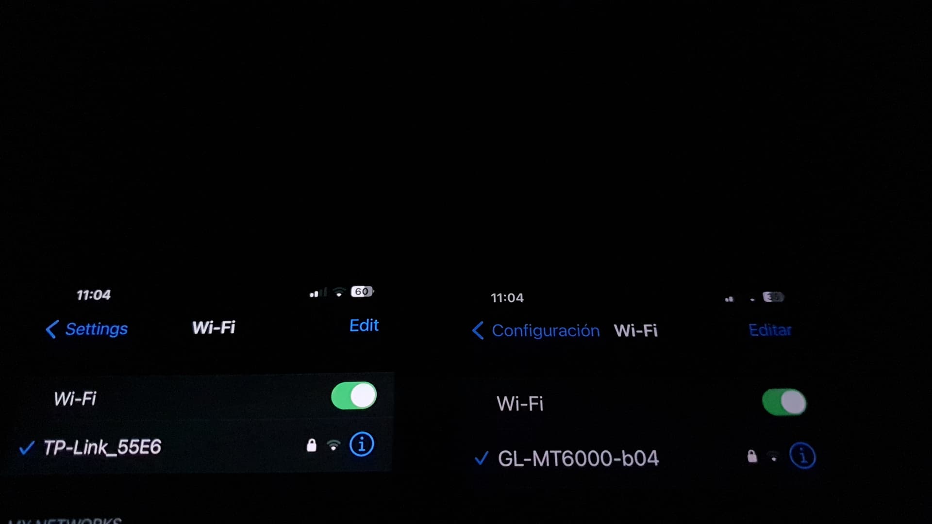

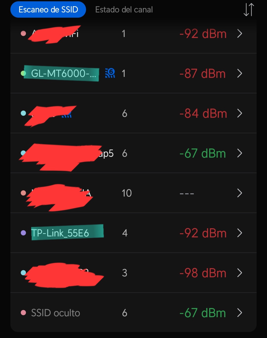

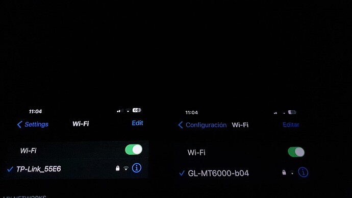

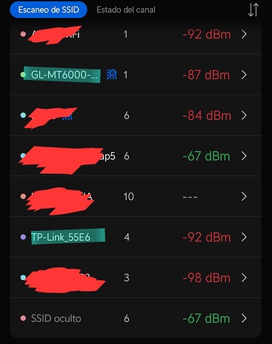

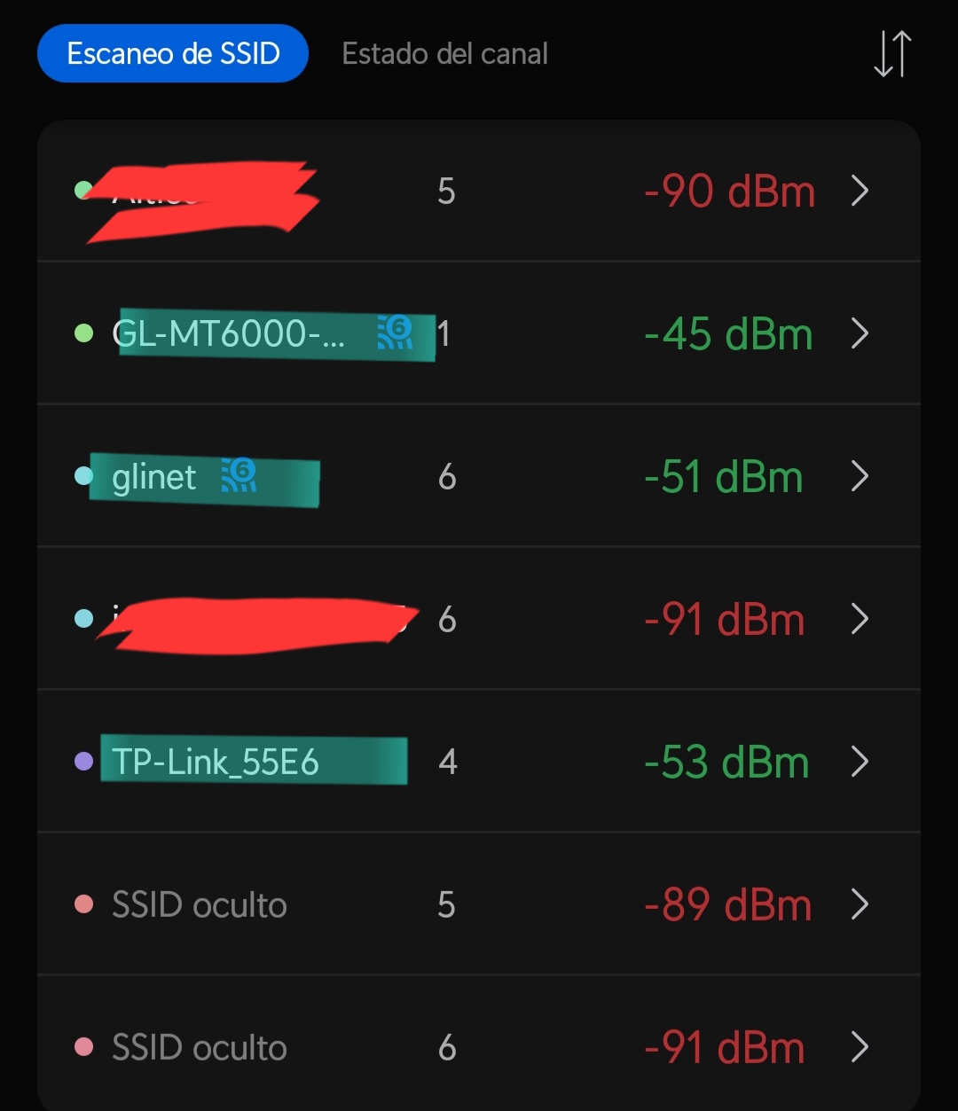

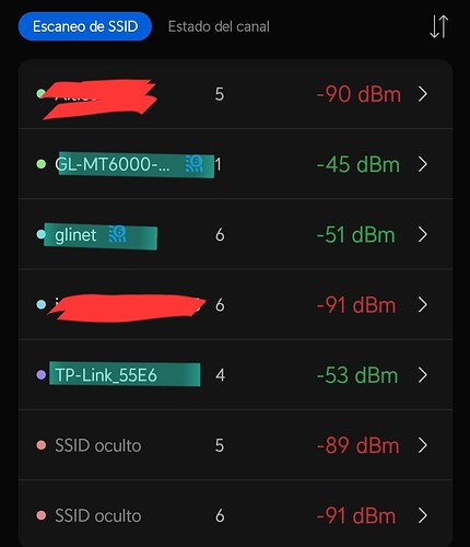

I tried the signal strength on my backyard and I can tell it is just a little bit better compared to my TP-Link, I can safely say the Flint 2 range could be better, sometimes I got 2 bars on my phone on this same spot, but that was very hard to see, and surprisingly the phone that was connected to the TP-Link network also got 2 bars a few times, in terms of dBm the signal is always higher, but just a little bit. Yesterday I saw a huge difference having the router less than a meter away so I guess the 4 antennas play a big role here. It’s hard to measure but I don’t think it is transmitting at 1000mW like it shows on luCI, I would say 22-24dBm. Who knows. The TP-Link is transmitting at 20dBm, I will leave some pictures here.

The range is ok to me on v4.5.6 even though it could be better. Look at this, 6 meters away with a wall in the middle the TP-Link and the Flint 2, (both on the same spot) this shows a 8dBm advantage on Flint 2’s favor, my Beryl AX is approximately 13 meters away with no walls and obstructions at all and the signal is lower compared to the Flint 2, but a bit higher than my TP-Link
