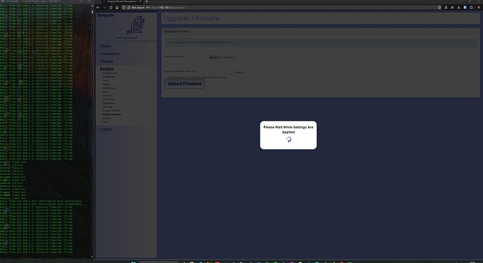

GL-MT6000 received Gargoyle support
Hlleo all,
@Lantis published the version with support for GL-MT6000 for Gargoyle, more information can be found here!
https://lantisproject.com/gargoyle_custom/1.15.x_2305_test_builds/mediatek/
https://www.gargoyle-router.com/phpbb/viewtopic.php?p=65804#p65804
https://www.gargoyle-router.com/phpbb/viewtopic.php?t=17921
The procedure is identical to OpenWrt, use sysupgrade.bin
