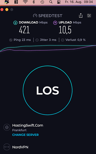

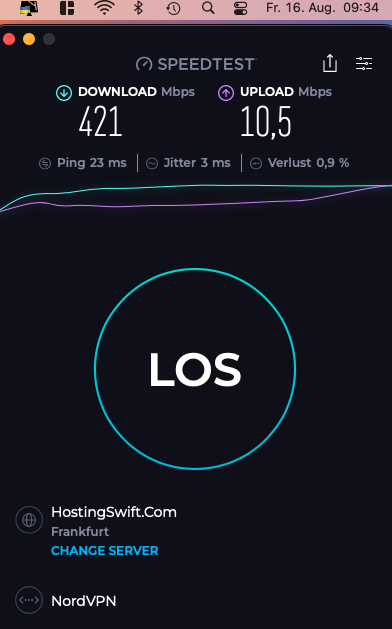

I only looked back at 40 tests, that was the only time where it was 1.7%, otherwise 0% or maybe 0.54%.
A packet loss of up to 1% is considered normal. Maybe the 1.7% had their microwave or something else disturbing turned on by chance.
But no matter how it doesn't explain the slowing down throughout the day.

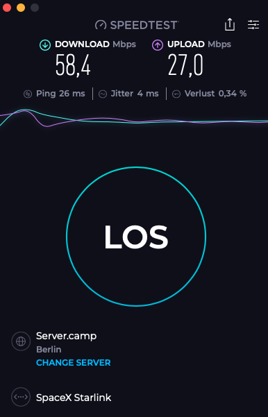

Just tested again to clarify.
Package loss >0 isn't normal, sorry to say that.
Zero is the normal.
  1. What is your Starlink plan?
  2. I'm not understanding these screenshots. You are reaching 420Mbps (download) and 10Mbps (Upload). What are you expecting?

Quite normal standard offer. 50 euros per month unlimited.
What I expect??? The router becomes slower and slower throughout the day until in the end it only has maybe 10 Mbit and has to be restarted.
Strangely enough, only the Flint 2 has this. I don't have this with an alternative router

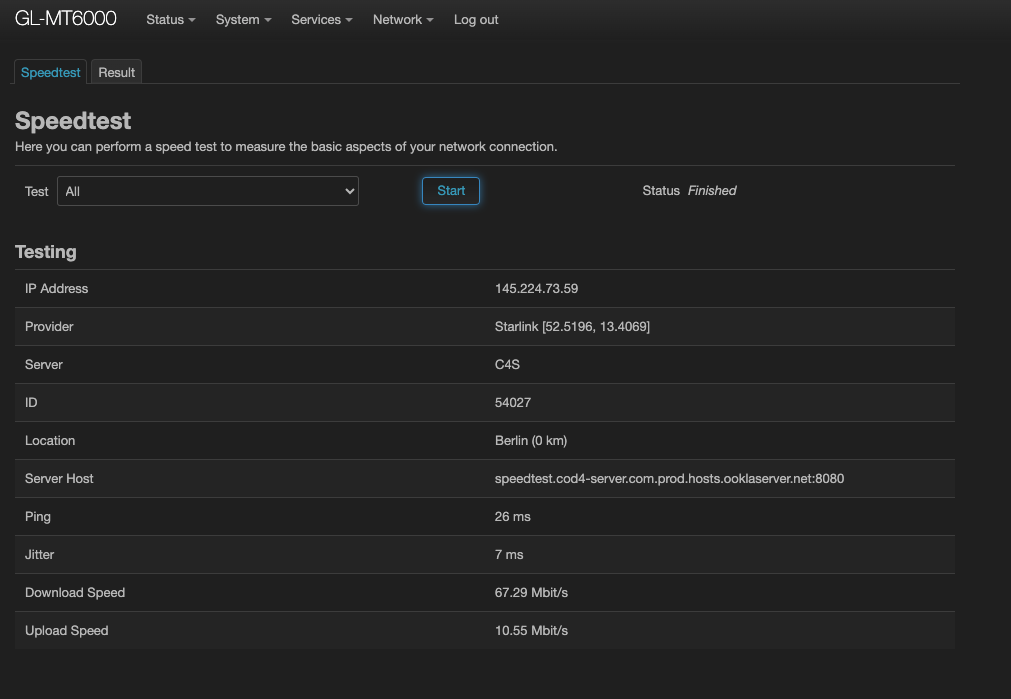

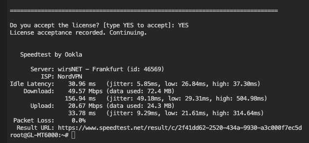

Can you run a speedtest on the Flint 2 via SSH while it's slowed down?
For example with:
wget -O /dev/null http://speedtest.wdc01.softlayer.com/downloads/test500.zip
or
wget -O /dev/null http://ams-speedtest-1.tele2.net/1GB.zip
Or even better with iperf3 (needs to be added as a package)
Best way, imho, is using a real speedtest:
wget https://install.speedtest.net/app/cli/ookla-speedtest-1.2.0-linux-aarch64.tgz && tar xzf ookla-speedtest-1.2.0-linux-aarch64.tgz && ./speedtest
Bildschirmfoto 2024-08-16 um 10.12.17
Bildschirmfoto 2024-08-16 um 10.13.07
If you take the VPN out of the question, is the speed normal then?

The funny thing is that there are no problems with the Asus ax86U and there are with the Flint 2. I'll see if I can do it later

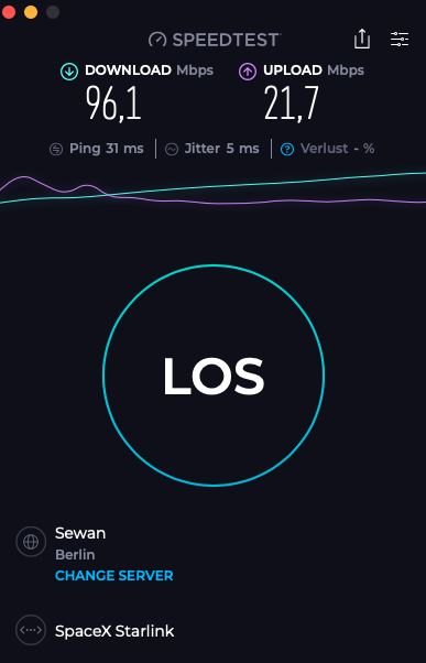

and here is Starlink Router Direct. But don't forget that the Starlink router is an absolute disaster. As far as performance and WiFi are concerned
