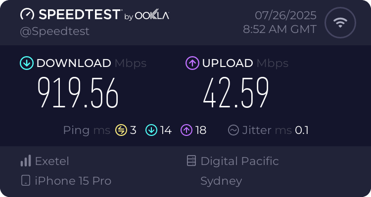

I got a bit curious about this one, and ran a connection test with my 1000/50Mbps connection with and without WireGuard, over ethernet, no hardware acceleration, 4.8.0-beta8 firmware. Got the following results:
There’s clearly some overhead with WireGuard (10% drop in DL 20% in UL), but honestly I think the router is doing a good enough job for me (the website says 900Mbps and it’s close). Haven’t tried with an old firmware lately, but the newer firmwares have enough new features and benefits to cover for it IMHO.
