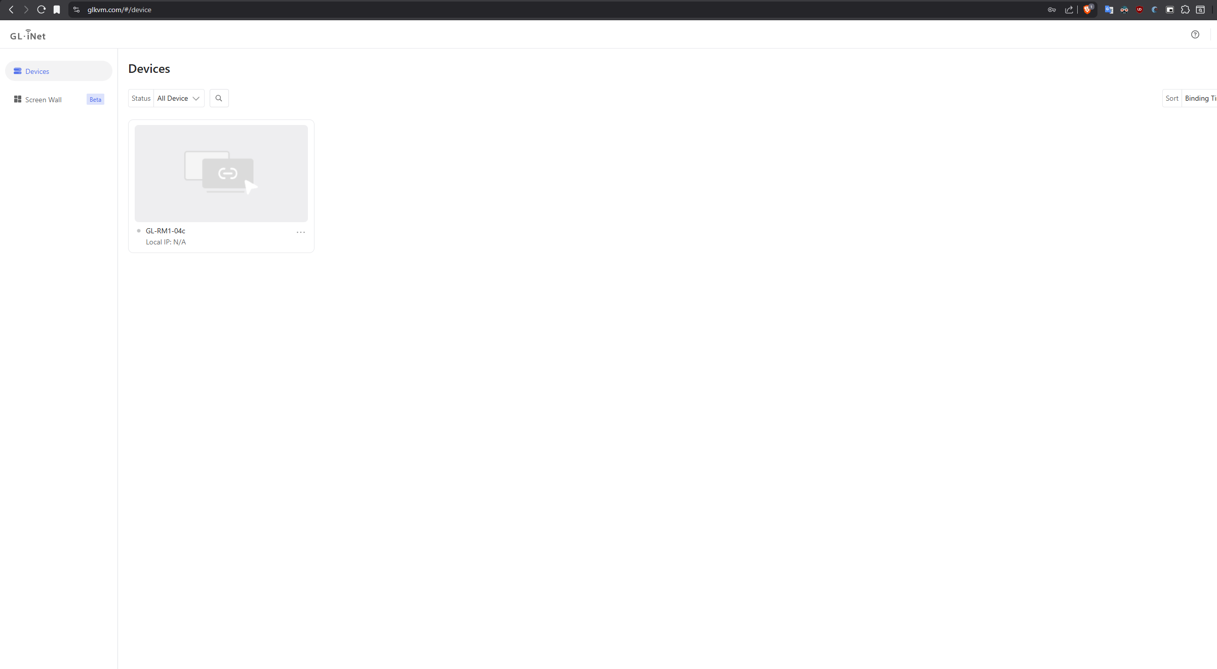

GL-RM1 cloud connection lost after a while even though local network works fine
I am unable to connect to KVM over cloud after a while using it. Local connection works fine however. I was able to do a cloud connection but it wasn’t stable since I have the RM1, when I first set it up I had the 1.7 firmware update and it had the same issue, I configured a static IP for the RM1, but the issue remains, I was waiting until new firmware release to see if it fix the problem, the current release 1.8.0 still has the issue, my ethernet connection is stable, disconect and connect the ethernet cable doesn’t fix the issue, I need to restart the device to make cloud connection work again and it only works for few hours. Not sure how to fix. Thank you

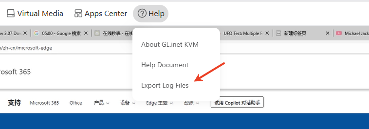

provide log to us

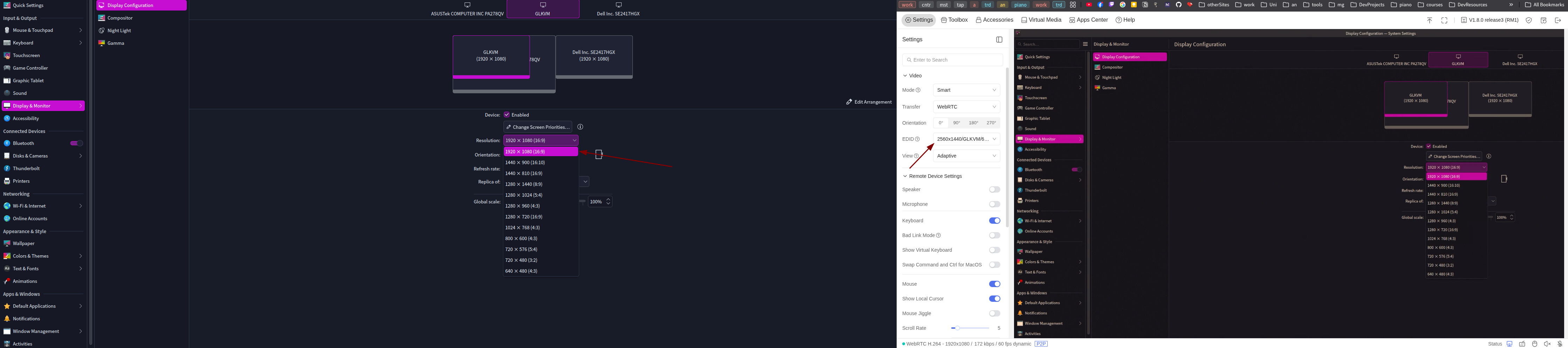

Maybe you can try to adjust resolution of Comet in Arch LINUX.
Yeah, I tried but it only shows 1920x1080 as the max resolution:
I have no idea. I also saw some similar problem on Windows, but it just disappeared no sense.
