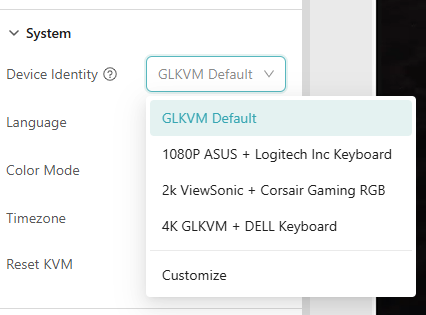

Disguised as a Corsair keyboard
run below command in webterminal
tee /etc/kvmd/override.yaml >/dev/null <<'EOF'
otg:
  manufacturer: Corsair
  product: 'Corsair Gaming RGB '
  product_id: 26995
  serial: ''
  vendor_id: 26944
EOF
And then reboot comet. See if it can work , these line disguise comet as a Corsair device

Try the 1.4.0 beta2 version in the forum? You can switch the disguised device on the webui.

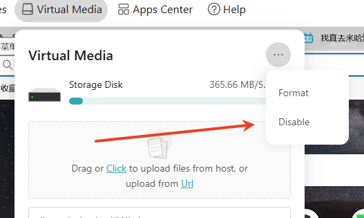

OR try disable MSD

I also updated to the 1.4.0 beta2 version, changed the Device identity, and disabled Virtual Media. Still the same issue in the Status section, bottom-right corner of the page.
