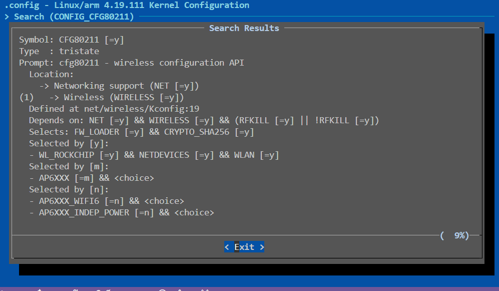

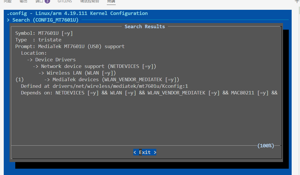

not the problem youi mention
I don’t remember I remove any kernel option of WiFi.
Thanks a lot. I think we're looking at different kernels.
The screenshots show Linux/arm 4.19.111, while my device (GL-RM1PE) runs:
  • Firmware: rm10rc-1.8.1-release1-11-g7ecf0591b1 (Buildroot 2024.02)
  • Kernel: 6.1.141 aarch64
  • Target: rockchip_rv1126bp_gl_rm1_poe

OK, that make sense. My configuration is from RM1. I will give you RM1PE test firmware, give me some time.
