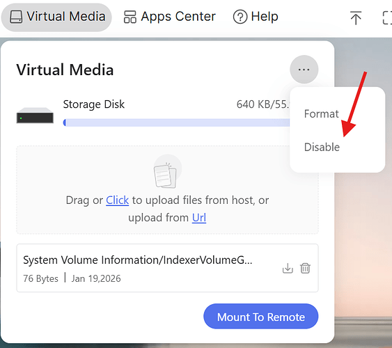

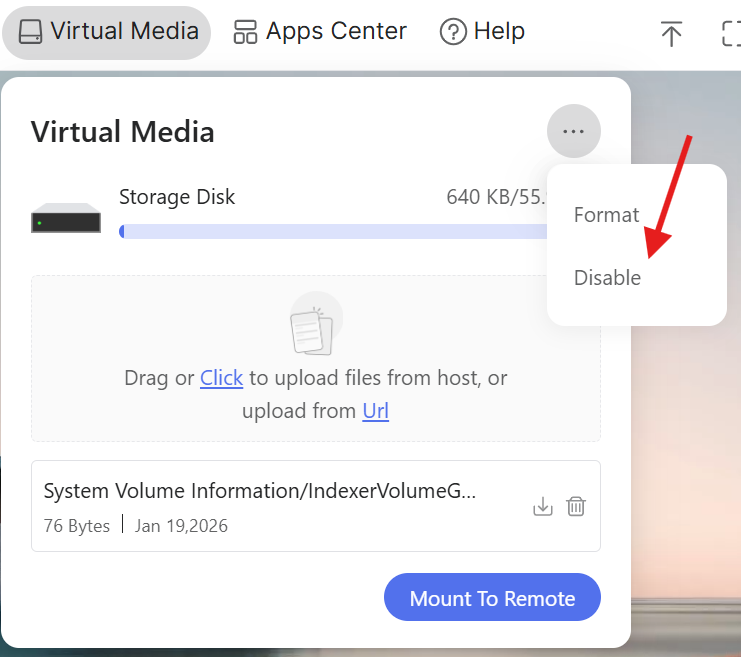

Please try disabling virtual media.

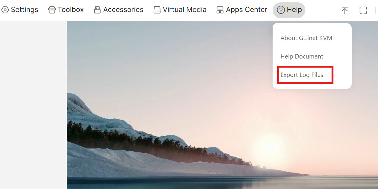

If the problem persists, please export the logs and send them to us([email protected]).
