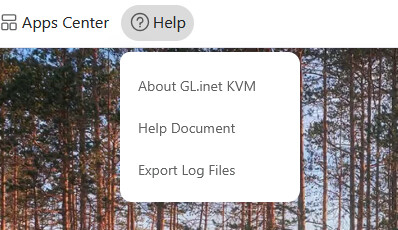

Strange , can anyone provide a debug log to us ?
