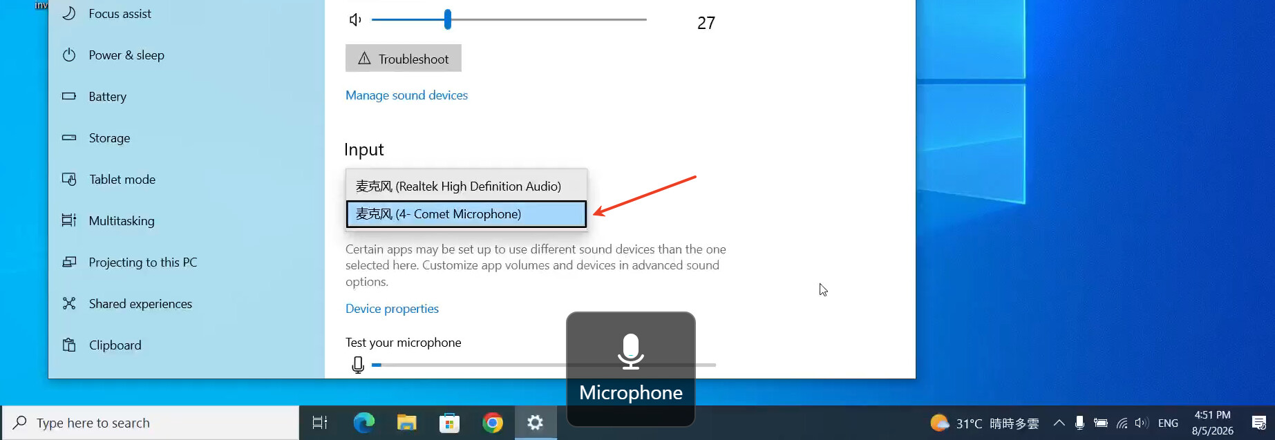

Thanks for the feedback. Regarding how the microphone works: when enabled, the RM10 emulates a USB input device on the controlled device. You’d then see a virtual microphone like Comet Microphone under Sound Settings-> Input on the controlled device.

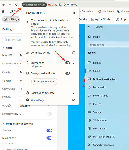

If it doesn’t show up, please ensure you’ve enabled the microphone in the RM10 Web UI and allowed microphone permission in your local browser, as shown below.
