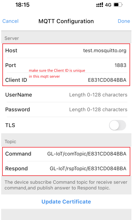

I think the current problem is that S10 did not successfully connect to the MQTT server. I had test it in my office and it works. So can you try to follow my confiruration and test again?
