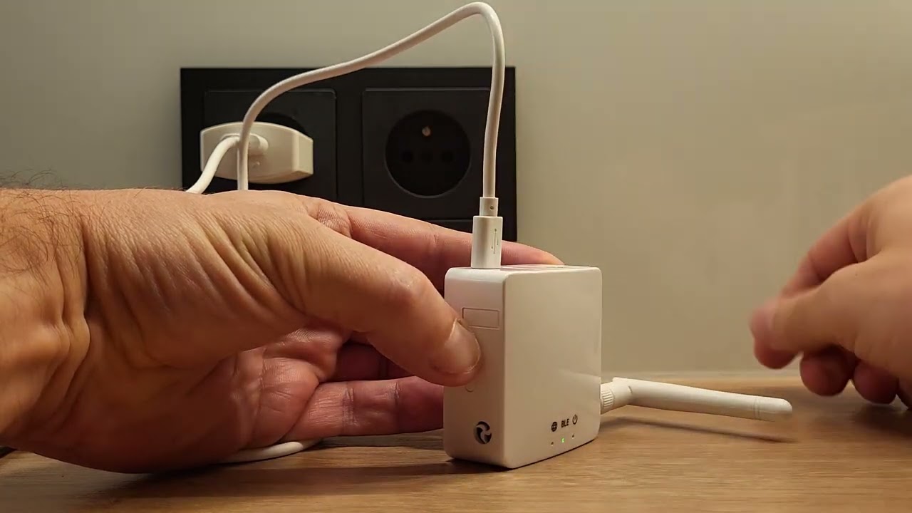

Can you show me where the reset button is
According to the instructions
That's the one I hold down before plugging in the micro usb.
Does the power led ever come on
While holding the reset I turn on the power,
the BLE diode lights up for 1-2 seconds and goes out,
then the power diode lights up,
then the white network diode flashes.
This is shown in the video above from my first post.
You can't get the BLE diode to flash, which signals pairing mode.
