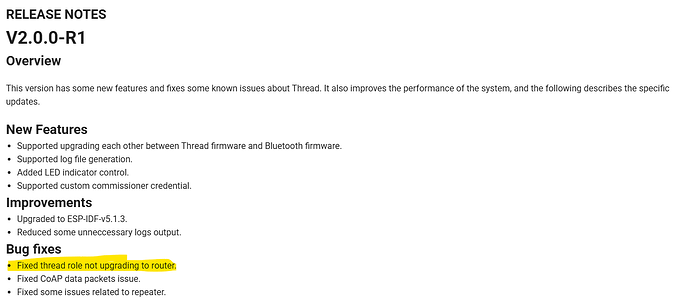

The bug we are facing seems to be fixed with the 2.0.0-R1, regarding the release notes
Unfortunatly, we still facing it
