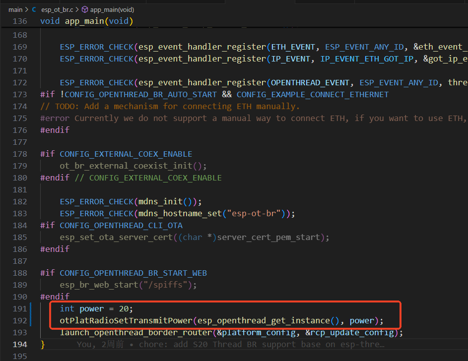

You can configure the thread Tx Power by modifying ./main/esp_ot_br.c as follows at build:
Refer:Radio Configuration  |  OpenThread
